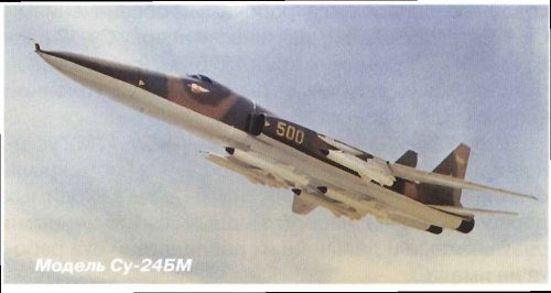

Nagumo said:
Novo C is probably captured F-14 https://www.cia.gov/library/readingroom/docs/CIA-RDP88T01079R000200090001-9.pdf page 14
Disagree. The quote says that US Embassy officers saw a twin-engined aircraft with moveable wings and twin vertical tails flying near Irkutsk, which might be the NOVO-C possible Fencer followon.
This implies NOVO-C had already been observed at Novisibirsk prior to August 1987 and might be the aircraft seen.
This implies NOVO-C looked like a FENCER followon, appeared to have moveable wings, twin engines and twin vertical tails (in order to make sense of this report).
Sounds consistent with an Su-24BM mockup....
