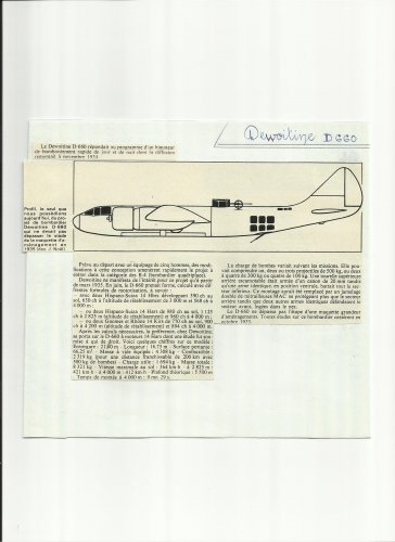

HI ALL
From an old "aviation magazine"
who know more about the Dewoitine d 660 project
for a fast bomber dated 1935 ?

Looks like it it might have been another victim of the (government inspired) chaos the French aviation industry was in at the time.
