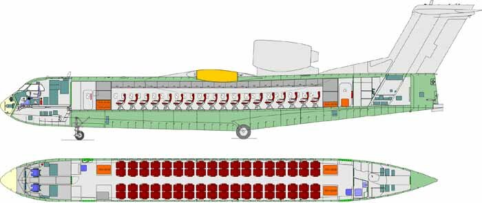

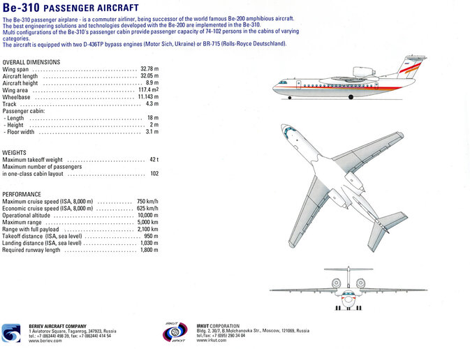

As expected, Unflown Wings is wrong. Compare the Beriev drawing of Be-210 above with the Be-310:
be-310-jpg.118907

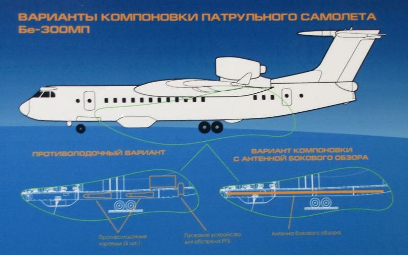

Be-300MP
Therefore, the projects of the Aircraft Company to create on the basis of the Be-200 "land" variants with the replacement of the "boat" fuselage with a conventional one (aircraft type) became quite logical. It is known that TANTK is currently working on two "land" versions of the Be-200 - the AWACS aircraft and the Be-250 control (for a promising radar system developed by the Vega concern) and the Be-300 aircraft in the patrol and anti-submarine Be-300MP versions ( with the installation of a promising search and sighting system "Kasatka" developed by JSC "Radar-MMS"). "Kasatka" is also offered for the new patrol version of the Be-200 amphibian under the designation Be-200MP.
From Russian book about Beriev,1968-2002.
