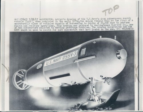

An artist's impression of a Westinghouse DSSV was produced in 1967, with a copy appearing on eBay here:
http://www.ebay.com/itm/1967-Artist-Drawing-US-Navy-Deep-Submergence-Search-Vehicle-Wire-Photo-/300613030365

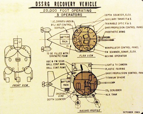

The original Recovery Vehicle concept from the Deep Submergence System Review Group in 1963
The Deep Submergence Systems Review Group recommended this undersea search vehicle to the Secretary of the Navy in a report, April 1964. The proposed vehicle will be used to investigate ocean bottoms and recover objects.
Master Caption: Following the loss of the submarine USS Thresher in April 1963, the Secretary of the Navy established the Deep Submergence Systems Review Group to analyze the requirements for placing man at great ocean depths. The study included an examination of plans for the development and procurement of components and systems related to the location, identification, rescue from and the recovery of large and small boats, including submarines, from the ocean floor.
It's interesting that this is termed a Recovery Vehicle, rather than a Search Vehicle, and in general configuration it fairly closely resembles the ALVIN and SEA CLIFF. There's also a missing photograph no. USN 711459 between this and the Rescue Vehicle, which presumably shows something from the DSSRG.

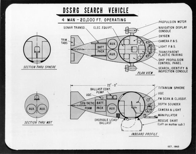

The MIT Museum comes to the rescue here, with the Search Vehicle:
The proposal for separate Search and Recovery Vehicles is interesting, and doesn't align with what I've read elsewhere. Unfortunately I can't find so much as an archive record for the report of the DSSRG - although these images clearly come from it.
