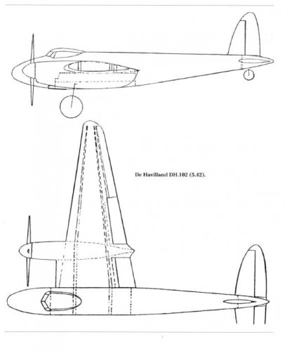

it is very close to DH-102.

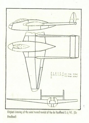

Hi all
Sorry ! I don't remenber where I've foud this !
Chorlton and Buttler reproduce a copy of it, cleaned-up and slightly simplified. They attribute it to "De Havilland via Aeroplane".
They also reproduce an original manufacturer's design drawing from 1941, obtained from the National Archives. It shows small differences, such as a slight forward weep to the tail plane trailing edge (deepest chord in the middle), low forward extensions of the tailbooms with what might be additional guns fitted, and a longer rear cockpit canopy/fairing. Has the same rather tall leaf-like tail fins as the wind tunnel model.
I cannot help but wonder what the provenance of the twin piston-engined fast bomber design is said to be. DH were apt to produce a new type number at the drop of a hat, would they really have re-used the same number for wholly different projects?
