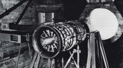

Catching on Tartle`s challenge ;) , here goes what I know about this great company`s endeavours on aircraft engine projects. DB had also the "P" prefix to their designs, and I will firstly post some turbojets.
DB-P100, a 13000Kg thrust giant, better known to us as the DB 016;
DB-P85, 6500Kg thrust, a smaller derivative of the 016;
DB-P80, with just 2000Kg.
They all had, as designed, 9-stage axial compressors and 2-stage axial turbines.

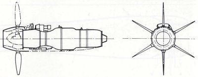

The only two DB turbines that went into hardware as far as I have discovered so far are the DB 109-007 bypass engine with counter rotating compressors [a la Griffiths] and the DB 109-021... the former was stated in 1940 but did not run until 1943 and the second is a turboprop version of the Heinkel Hirth 109-011 known as the 2000 hp 109-021 which went to DB after the 011 was abandoned.
I believe this is not correct. The 011 wasn`t abandoned, it`s Heinkel-Hirth turboprop version wasn`t either. I believe heinkel and DB were parallel developments, although very similar. I do not have my books around, but i am almost sure on this.
I am following up some wartime reports on this at moment... so hopefully can add some weight to discussion on this...its not that clear at moment.
