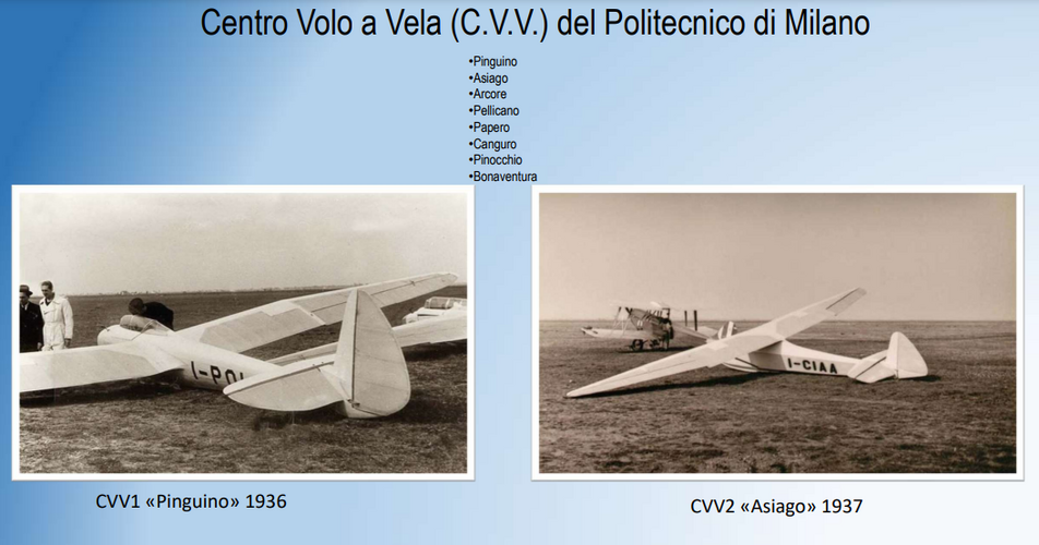

CVV 1 Pinguino - 1937 gull-winged sailplane, designed by Preti and Maurizio Garbell
- built by Aeronautica Lombarda, 15.3 m span, 4 built (eg: I-POLI)
CVV 2 Asiago - 1937 single-seat parasol-winged training glider, Preti and Garbell
- built by Aeronautica Lombarda, 13.7 m span, 60 built

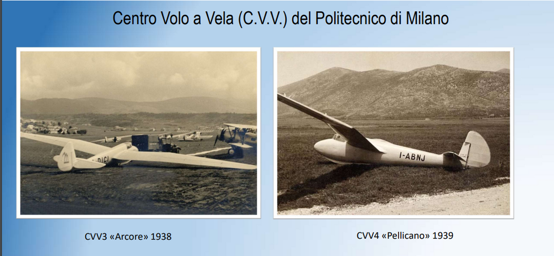

CVV 3 Arcore - 1938 single-seat gull-winged sailplane, 15 m span, 4 built (eg: I-DICI)
CVV 4 Pellicano - 1939 single-seat gull-winged glider, 15 m span, 1 built (I-ABNJ)

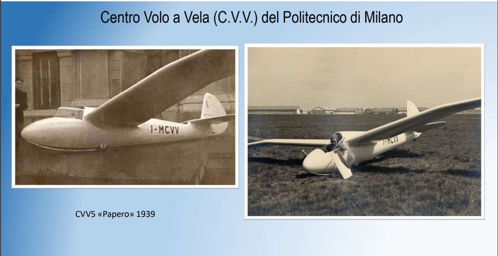

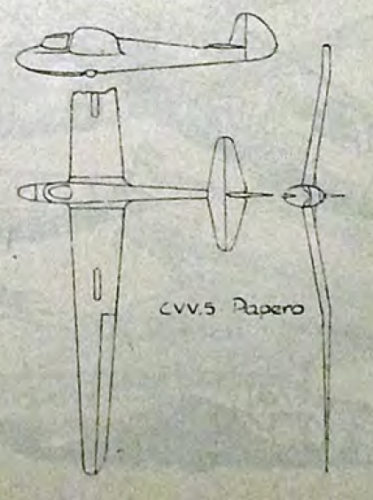

CVV 5 Papero - 1939 single-seat, gull-winged sailplane (deriv. from CVV 4), 4 built

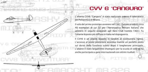

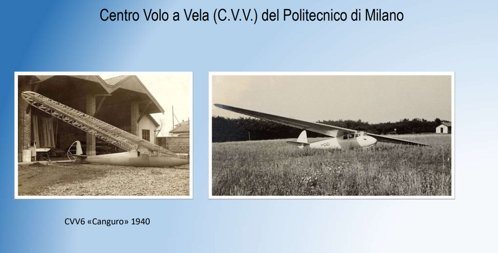

CVV 6 Canguro - 1941 tandem-seat, high-winged sailplane, 52 built (by S.A.I Ambrosini)

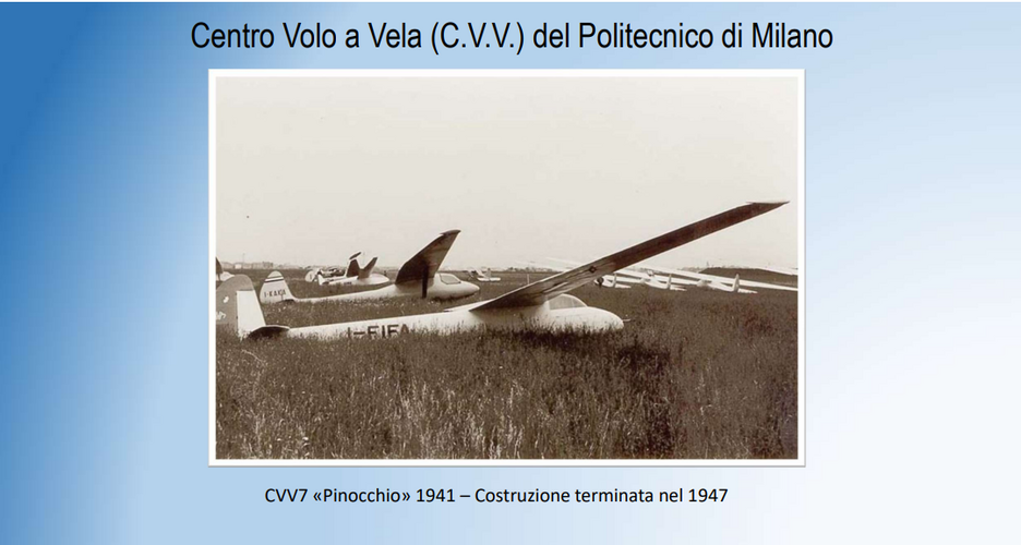

CVV 7 Pinocchio - 1952, single-seat (18.5m) sailplane, 1 built by CCV (I-FIFA)

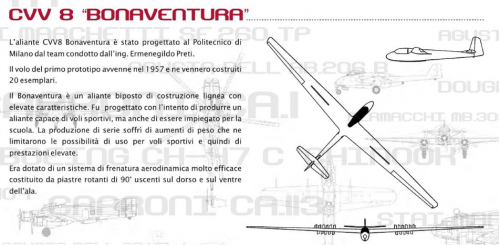

CVV 8 Bonaventure - 1957 2-seat high-winged sailplane, 19 m span, 20 built by CCV

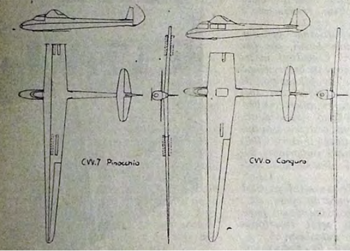

here is a drawings to CCV.6 & CCV.8.

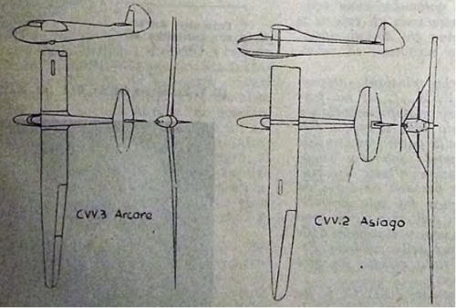

Some drawings to CV gliders.
http://www.avia-it.com/act/biblioteca/periodici/PDF%20Riviste/Ala/L'Ala%201948%2002.pdf
