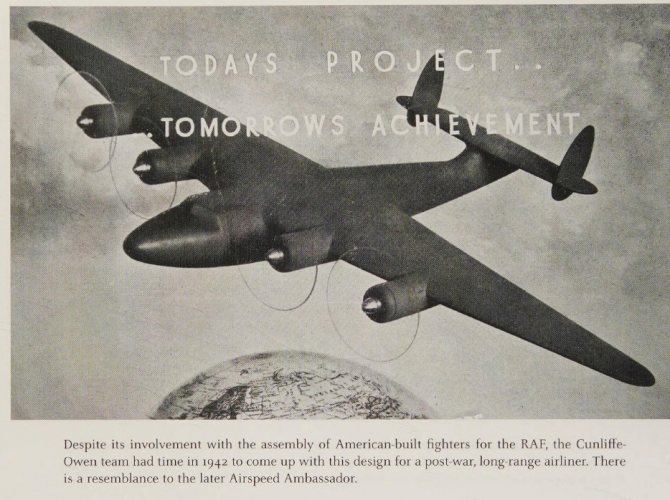

Cunliffe-Owen four engined transport aircraft
Hesham ,
This is commercial art only I am afraid... not a projected design.
(last aircraft was their COA 19 Concordia ,abandoned in November 1947)
Stupid question, who's Cunliffe-Owen? Are they in someway related to Airspeed? It looks like a 4-engined Ambassador to me.
Not a Burnelli fan, eh? ;D
Cunliffe-Owen Aircraft was a small firm set up at Eastleigh to build the UB-14 licenced as the OA-1. A prototype was built but the OA-1 tanked. The unbuilt OA-2 project was also a Burnelli-type lifting body design.

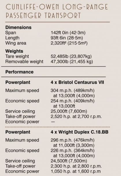

Not a good idea to bring these fossil threads back from the dead but I decided to do so as the answer given above was incorrect. This was indeed a genuine project designed for a speculative airline venture that C-O hoped to launch with Cunard White Star as partner.
