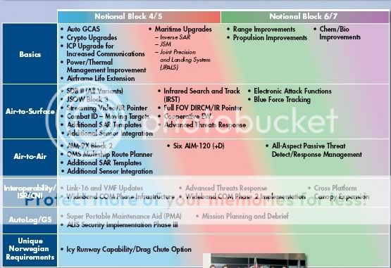

I don't think that there is that much bandwidth at this time.
A hint at future capability is the notional Blk5 F-35 feature called "Cooperative EW".
