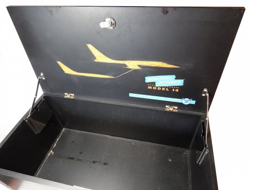

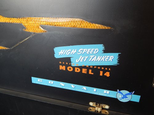

The Convair Model 14 was a high-speed (likely supersonic) jet refueling tanker, as shown on the proposal model carry-box. Based on the box handle design, this project had a delta wing, as did all Convair combat aircraft at the time (F-92, F-102, F-106, B-58, Sea Dart, etc.)
