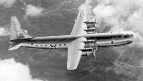

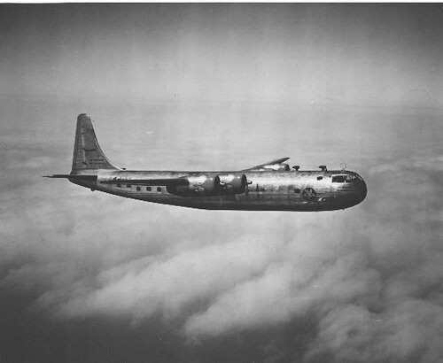

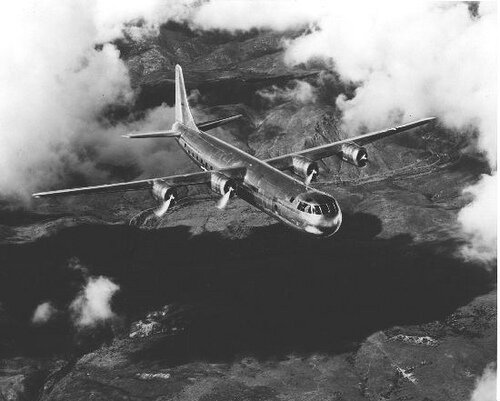

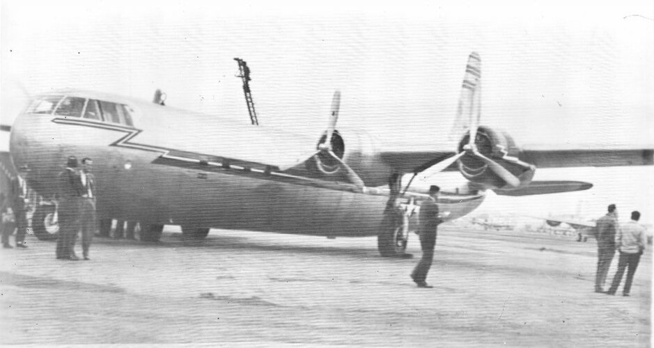

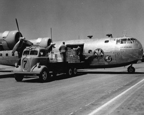

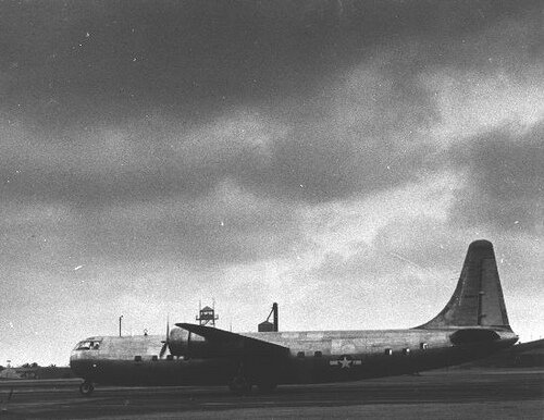

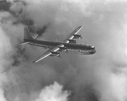

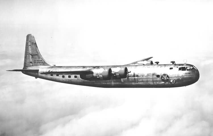

The R2Y-1 was the Consolidated Model 39 Liberator Liner (redesignated as Consolidated-Vultee Model 104).

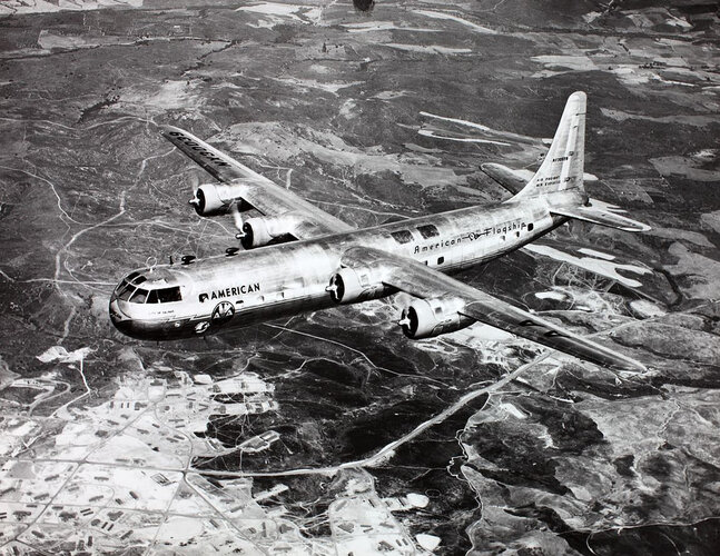

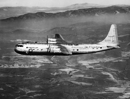

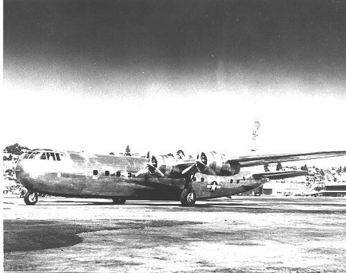

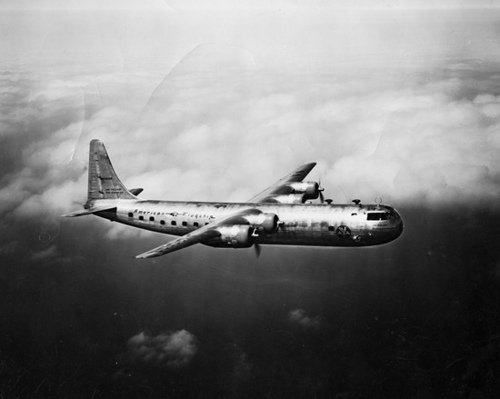

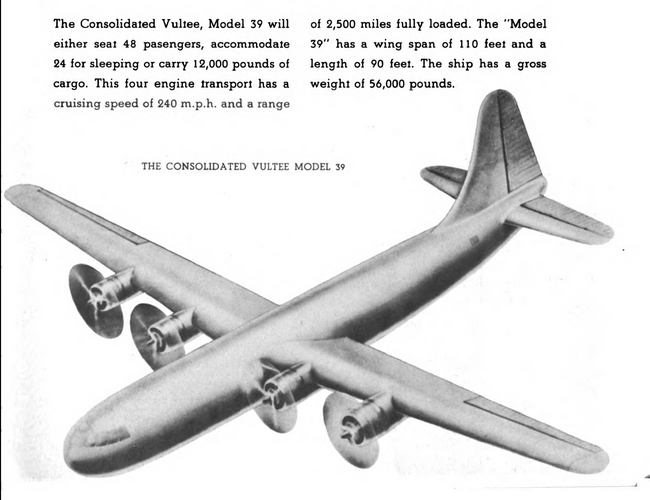

What is the difference between the commercialized Model 33 (a B-32 Dominator derivative -- see top photo) and the Model 39 (bottom photo)? Both projects appear generally identical to me.
While the Model 39 is a B-24 Liberator development, it uses the the vertical fin of the B-32. Further, the design study serialization is not chronological, as the commercialized Model 33 appeared in May 1943, after the commercialized Model 39. I'm a bit confused.
The Model 33 is considerably larger with a 12' diameter fuselage and 135' wingspan.
The vertical tail of the Model 39 is from the PB4Y-2 Privateer.
As a B-24 development the Model 39 was preceded by the Model 32, which in profile looked very similar to the Avro York,
however with a round rather than square cross-section fuselage.

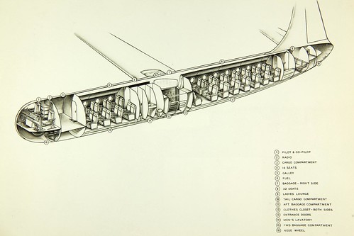

No three-views, but hopefully helpful, a couple of cutaways posted at the San Diego Air & Space Museum (SDASM) Flickr Photostream, plus a whole bunch of photos, including some of the interior and cockpit (link):
http://www.flickr.com/photos/sdasmarchives/7585835628/in/photostream/
http://www.flickr.com/photos/sdasmarchives/7585835708/
