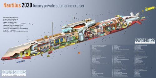

concept design of luxury private submarine mega-yacht
covert_shores
Research + illustration
Oct 31, 2014
671
35
www.hisutton.com
Inspired and referencing Jules Verne's Nautilus. Some interesting design features, but frivolous use of space in keeping with mega-yacht theme. In my head there'ds a smaller 70 meter version, possibly with gas turbine instead of the diesel generators. http://www.hisutton.com/Nautilus-2020_Luxury_Submarine.html

Arjen, yes that's why I compromised on the wave cutting upper bow. There would be bilge keels to slightly reduce roll on the surface, but it's designed for underwater travel. Especially in heavy seas, just submerge. Possibly it could semi-plane in surface mode, with the bow high and the pumpjets angled to be horizontal.
Orionblamblam, interesting idea. Challenge is that, generally speaking, the better it is above the waves, the worse it is under the waves. Pressure hulls have to be certain shapes, and heavily constructed. So most of superstructure would have to be flooded when submerged. So no state rooms or ballrooms up there.
I was going to go for more of a yacht shape with sadle tanks and larger superstructure but Verne's nautilus was too much of an influence. :)

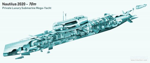

Added a 70 meter version. Crew accommodation, stores and aller rooms eliminated. Main compromise is that LOX comes inboard to pressure hull and snort mast removed. Ok design but I like the bigger one.
