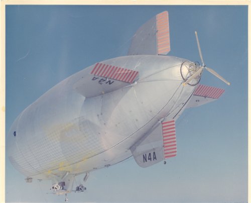

Never before published photo of the Project Silent Joe II airship and final report.
Developed by ARPA and Goodyear to investigate the use of an airship that would be able to maintain surveillance over the Ho Chi Minh trail. It would use LLLTV and infrared sensors to monitor traffic along the trail.

Absolutely amazing, it seems to be sorted by a Verne's novel!!
BTW what was the purpose of the rear propeller?
System is similar to POBAL-S which followed Silent Joe II. In the POBAL-S report the system was designed to increase maneuverability and reduce noise.
An interesting fact about the project, Goodyear used its N4A 'Mayflower' airship in order to conduct the tests. N4A was at the time one of Goodyears latest designs and one of the fastest non-rigid airships. You can even see the 'Skytacular' electronic sign system on the port side.
Sometimes the best place to hide something is in plain sight! ;)
Unfortunately, the Mayflower crashed October 30, 1999, when a broken gear and drive steering system sent the airship in to a descending left turn from 600 ft AGL. Fortunately, no one was hurt.

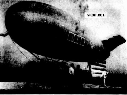

Obtained some additional data on the Silent Joe I airship, seperate of Silent Joe II project. Apparently the first Silent Joe was a 5,300 cu ft remotely controlled drone airship deployed over Southeast Asia carrying 'microphones and a radio transceiver,' for the purpose of detecting 'truck convoys and troop movements.' It was developed and deployed by the Range Measurement Laboratory based at Patrick AFB in Florida.
Sorry for the quality of the photo in the pdf. The information is from:

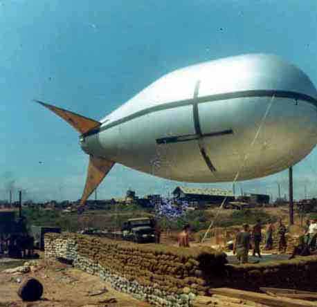

As a side note on balloons over Vietnam and SEA during the war, the NSA was also hard at work developing surveillance and communication technologies including this small aerostat, which was deployed near the DMZ in Dong Ha, Vietnam.

Maverick, I'm not sure which aircraft you saw. Possibly an RC-12 with antennas mounted all over the wings and fuselage. Its definitely a 'bizarre' look for an aircraft. The RC-12 could have been used to transmit signals from the blimp to the ground in an effort to extend the range of the transmissions. Silent Joe II, however was never deployed over SEA and only conducted nine flights between 1968 and 1969. Here is a picture of Silent Joe I. It was a smaller blimp designed by Sheldahl Co.
