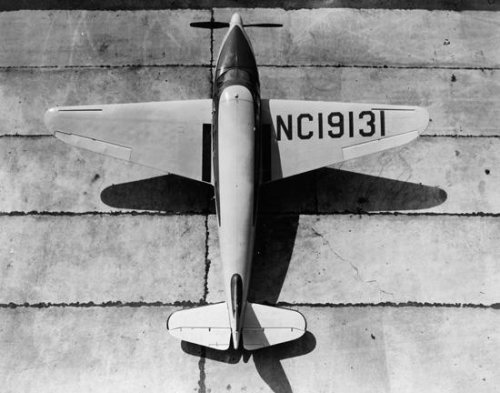

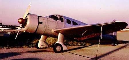

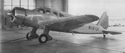

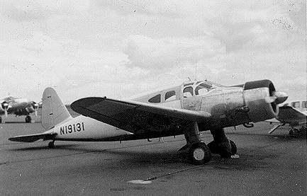

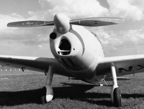

I've been lookin for more info on the Clark ga-46. Anybody?
The Clark GA-46 (also known as the Fairchild F-46) was an attempt to build a general aviation aircraft in lean years using the then-revolutionary Duramold process.
Like so many other general aviation types of the immediate post-war era, it never found the market it was created for, because of the surplus in military trainers, observation and utility types that could be acquired for much cheaper.

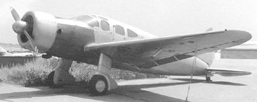

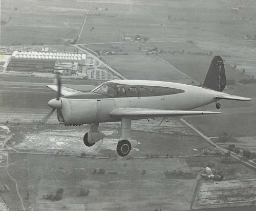

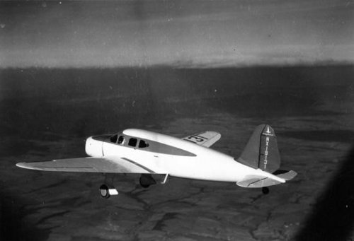

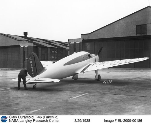

Here is a series of pictures I have... As you can see, the aircraft was tested with both a radial and an inline engine.

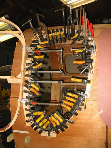

Further to the above I have found on http://aviadesign.online.fr/manufacturers/fairchild/pages/f-46.htm, that this rare bird has been restored by Big Sky Stearman company, see also http://deluxe_o_rama.tripod.com/fairchild46/. There has been a fair bit of termite damage leading to sections like the fuselage having to be rebuilt! F464.jpg
