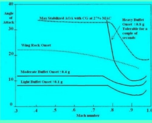

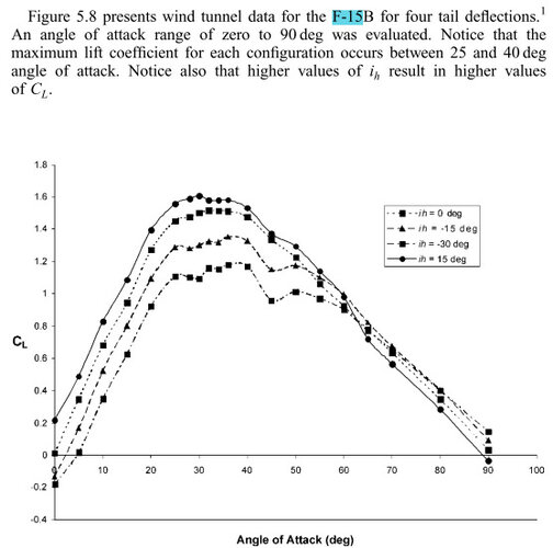

To avoid taking the Su-57 thread off topic, and to set the record straight by providing data straight from McDonnell Douglas themselves, here's some actual max ITR data for F-15C, unless @PeregrineFalcon has information to prove that they are wrong about their own aircraft.
And for the record, on the F-15 the AOA[units]=AOA[degrees] + 11.
This is to show that first of all, 40 degrees AOA is actually usable, and F-15 can reach those AOAs well under 700km/h that's been thrown around here.
