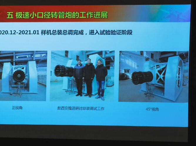

I'm not exactly sure what twenty barrels would do that four five-barrel or three and a half six-barrel weapons couldn't. It's an interesting answer to the PD Question, for sure.

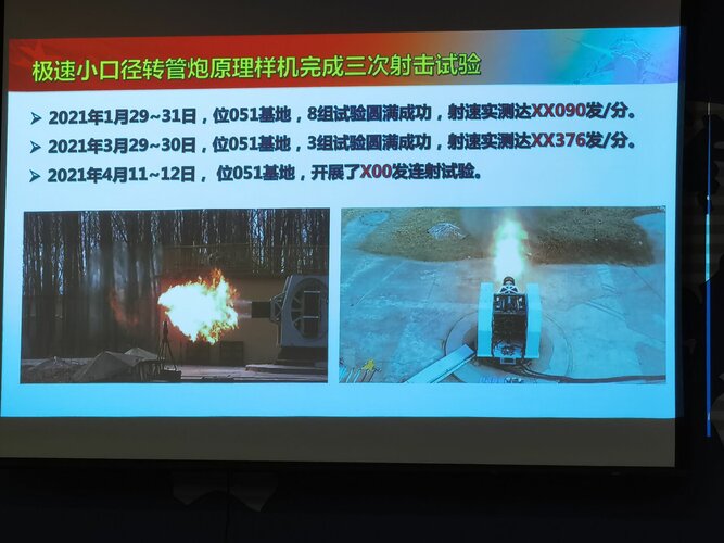

How many seconds does it take to "spin up" a 20-barrel Gatling Gun?
Approximately 3x longer engagements, or 3x more short engagements before the barrels reach temperature or life/wear limits?
But do existing systems even have enough ammo on hand for that to be an issue?

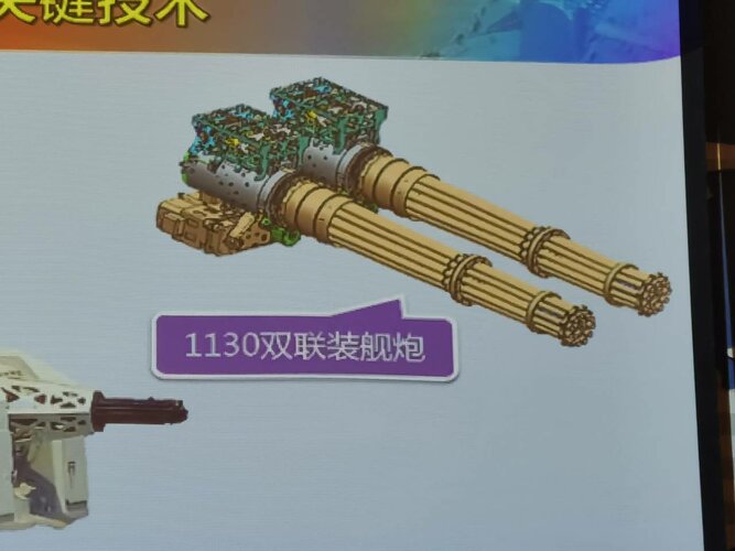

BTW, the source article doesn't make it totally clear that this gun actually fires two barrels in tandem, one at the top of the barrel group and another at the bottom.
So it's only achieving about 30-40% more "time between shots" compared to 6- or 7-barrel Gatlings at the same RPMs.
I was just wondering about multiple firing points on the cycle anyway. That's the only reason I can think up to build something with this many barrels.
But it means that there are at least some failure points that prevent both barrels from firing -- the rotator mechanism, certain kinds of jams (failure to extract in particular), etc. Seems like two guns would be more reliable on balance and unlikely to weigh much more.

As those Russians think it’s better, two Gatlings are connected in parallel
The advantages of having one 20-gun over two 10-barrel are mainly in the mount: with just one gun, you do not need to take parallax into account (like on AK-630, which have one director station controlling two gun turrets), and the mount is not destabilized by side-placed guns recoil (like it would be with two guns on sides of one mount).
