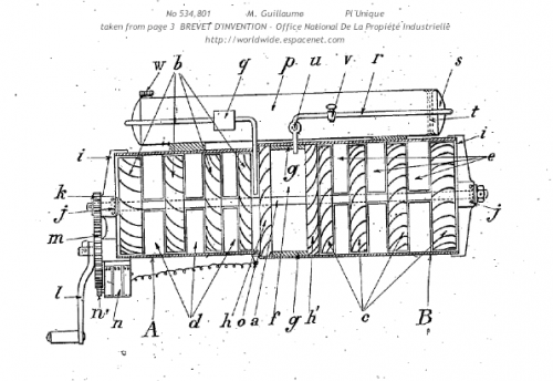

The French patent seems to be by Maxime Guillaume from 1921 but the Espacenet doesn't want to play ball. Image from wikipedia.
http://worldwide.espacenet.com/publicationDetails/biblio?CC=FR&NR=534801&KC=&FT=E&locale=en_EP
Propulseur par réaction sur l'air
Inventor:
GUILLAUME MAXIME
Applicant:
CPC:
B64C11/001
IPC:
B64C11/00
Publication info:
FR534801 (A)
1922-04-03
Priority date:
1921-05-03
