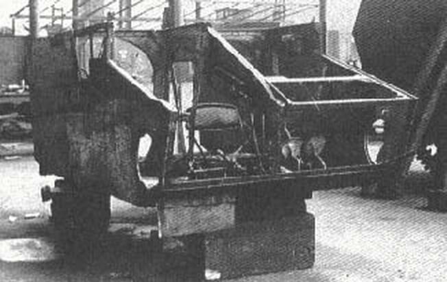

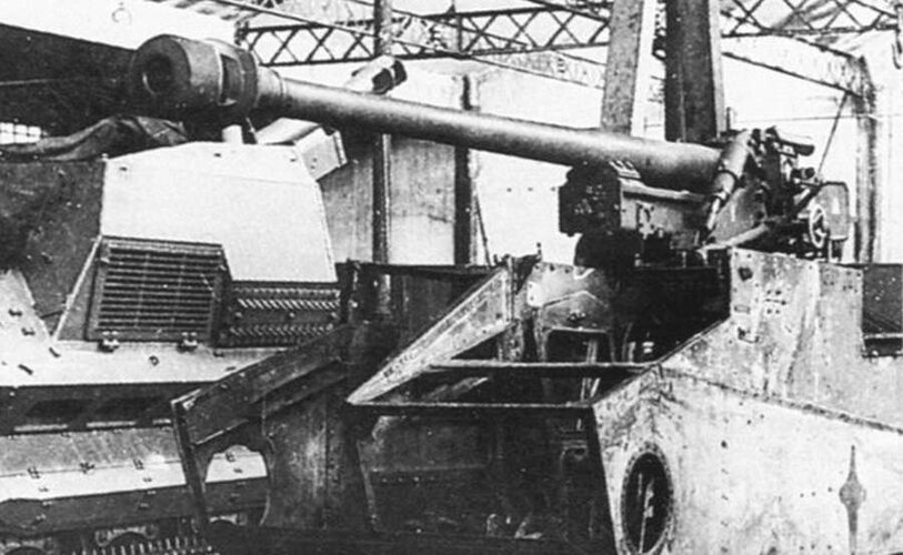

Also, captured Mark VIs were slated to be panzerjagers (?) as well, evident by the photos I attached over what appears to be a factory conversion, though incomplete. (Note the 10.5cm leFH 18 (Sf.) auf Geschützwagen FCM 36(f) in the background) I cannot find any further information on this either aside from these two photos and a few bits about the designation. The origin of this other conversion and why it was cancelled seems to be a mystery all the same.

That Carden-Lloyd chassis looks seriously over-loaded.

But what of the panzerjager variant?
