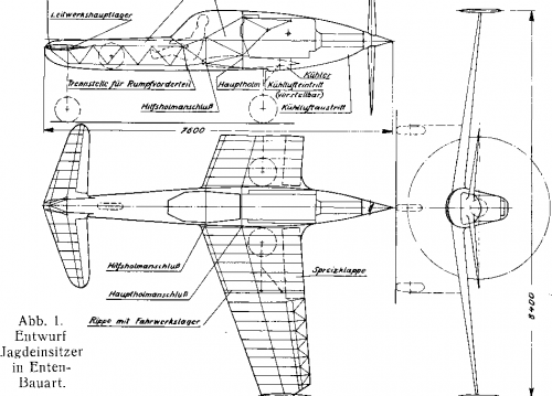

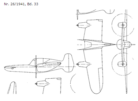

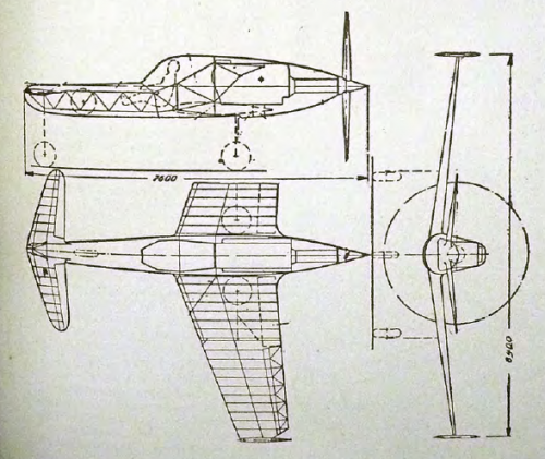

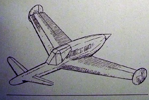

here is two unknown canard civil light aircraft projects of 1941.
Flugsport 1941

I can not make it out of the text ,but I think that both
concepts are Italian in stead of Lockheed designs..
I have seen that shape of canard before in Stefanutti designs.
Agreed, especially as the text on the linked page mentions Steffanuti by name.
Anyhow the first drawing is for a DB 601 powered single-seat fighter.
Der Entwurf (Abb. 1—2) eines Jagdeinsitzers in „Enten"-Bauart dürfte manchen Leser zu neuen Gedanken bewegen. Eine genaue Leistungsrechnung dieses Projektes (Entwurf 1939) ergab gegenüber einem modernen Jagdflugzeug in Normalbauart von gleicher Flügelfläche und gleicher Motorleistung bei Berücksichtigung der geschwindigkeits-erhöhenden Faktoren eine Steigerung der Geschwindigkeit um 60 km/h (d. h. um 10%).
Motor: DB 601, Fluggewicht G = 2200 kg, Flügelfläche Ffl-14 m2, Höhenleitwerksfläche Fl = 2,3 m2, gesamte Tragfläche F = 16,3 m2, Länge 1 = 7,6 m, Spannweite b = 8,4 m, Flächenbelastung Q/F = 135 kg/m2.

However, the text you've quoted is just a general discussion of the Ente layout, the illustrated examples are not
connected to Lockheed.

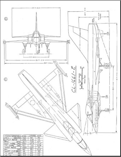

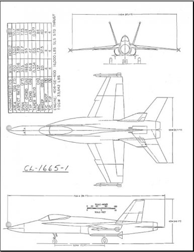

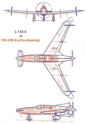

Let's not forget that for the sake of comparative studying of the competitors' submissions, Lockheed sometimes allocated them numbers within their own model number sequence! (see attachments) I'm sure this could easily be a source of mistake for the less discerning researcher (especially if they have, like me, little knowledge of Italian projects...).

The first drawing in this thread shows a very large engine and prop in a single-seat, retractable canard design. I am not at all convinced that the intention was either particularly "light" or exclusively "civil."
but how it could be a Fighter (first drawing) ?.
The German text 'Entwurf Jagdeinsitzer in Enten-Bauart' in the image itself translates roughly to 'Design for a single-seat fighter in canard-style'.
As jcf in reply #5 has already noted, the text that follows the image describes it as a 'Jagdeinsitzer in „Enten"-Bauart' too. Weighing in at 2200kg, DB601-powered, not exactly a design for a light aircraft.
I would think the design's nose offers enough room for the installation of several guns.

This is not a project , just an article by RAOUL JÖRN about what could be a canard fighter : I read some years ago this Flugsport , copied it , and noted the author's name
On the site pointed by Hesham , I can't find the name of the author , but I am sure , this was Raoul Jörn , and this was only "private" thinkings about an "Ente Jäger" and a lighter test aircraft ...

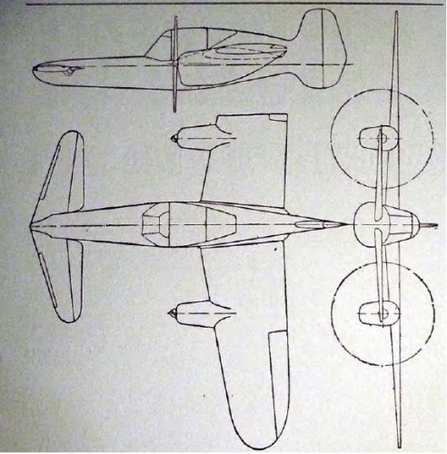

as my dear Richard specified before,it's a Projects from the engineering RAOUL JÖRN,
for a canard airplanes.
http://www.avia-it.com/act/biblioteca/periodici/PDF%20Riviste/Ala%20d'Italia/L'ALA%20D'ITALIA%201942%2003.pdf
