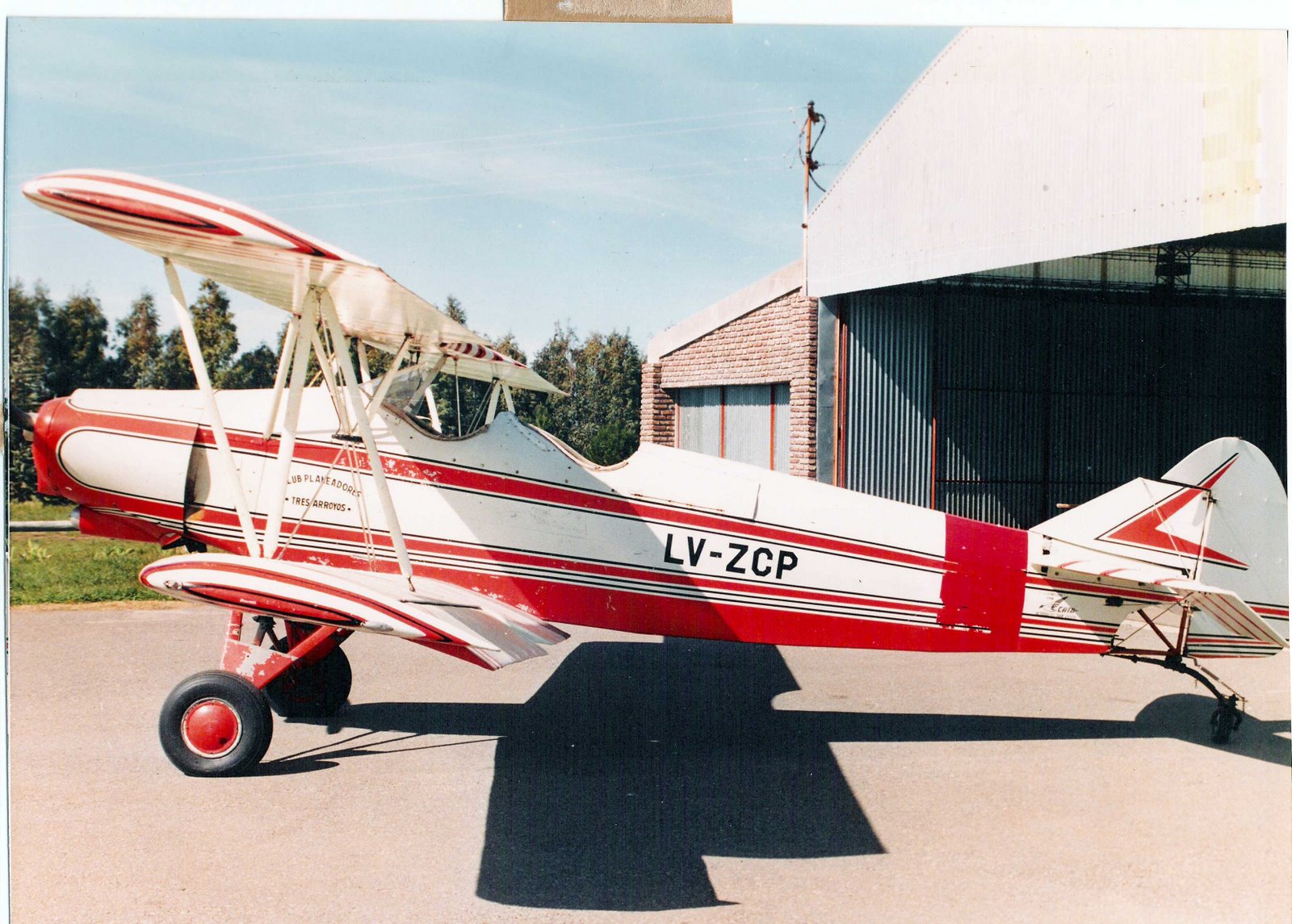

- Argentina: 1937 20 x Model 10A, DGAC aero club use
-- NB: 1972, CATA re-eng. c/n 111 with 150 hp Lycoming
-- http://4.bp.blogspot.com/_QjFSY3pMXdA/RgCKIqvPPaI/AAAAAAAAACc/DHoW1z7ElHM/s1600/fleetcata-1.jpg

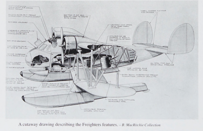

Fleet Model 50 - 1938 Freighter twin-engine biplane transport a/c, x 5
- Model 50J: Prototype, temp. Jacobs L-5MB, conv. to Model 50K
-- http://image-bank.techno-science.ca/databases/image_bank/dig_image.cfm?Lang=e&id=8263
- Model 50K: Prod'n vers., higher-powered Jacobs L-6MB, x 4
-- 3v: http://www.airwar.ru/image/idop/cww2/fleet50/fleet50-1.gif
-- http://image-bank.techno-science.ca/databases/image_bank/dig_image.cfm?Lang=e&id=21173

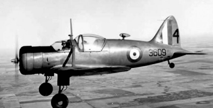

Fleet Model 60 - 1940 Fort 2-seat monoplane RCAF trainer, x 101
- Model 60K: Fort prototype, retractable u/c coverings/spats
-- http://www.airwar.ru/image/idop/other2/fleet60/fleet60-2.jpg
- Model 60K: Fort Mk I intermediate trainer, Jacobs L-6MB
-- http://www.airwar.ru/image/idop/other2/fleet60/fleet60-3.jpg
- Model 60K: Fort Mk II wireless trainer conv. (all Mk.Is ??)
-- http://www.avionslegendaires.net/wp-content/uploads/images/avion_militaire/G60k-fort-index-700x357.jpg
