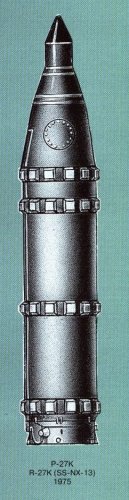

The USSR attempted such a system back in the day with the SS-NX-13 (a mod of the SS-N-6 IIRC). For that reason the USN kept the nuclear-armed version of Terrier around for a bit longer than they'd intended. When the USSR gave up on the concept the US got rid of the rest of the nuclear Terriers. As for this Chinese incarnation of the concept it appears to be similar in concept and capability to Pershing II albeit with the antiship capability. PAC-3 has hit manuevering Pershing II RVs in testing. LM is looking into sea-based PAC-3 MSEs (although I don't know if the USN is). As Jonsey frequently points out on Key Pub. though, you still need to be able to supply targeting data to the ballistic missiles. If China can't maintain a track on a carrier then those ballistic missiles are pretty much worthless.
I was unaware of the Soviet system, thanks sferrin!

SS-NX-13 aka R-27K (4K18)
2.0 to 3.5 MT warhead
