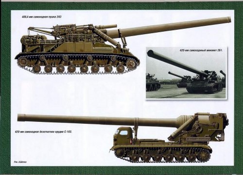

Can anyone please ID this Soviet SPH (its designation, its specifications etc)?

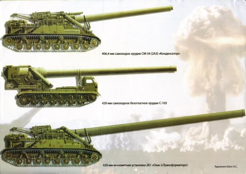

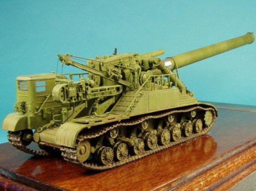

I hope this helps...

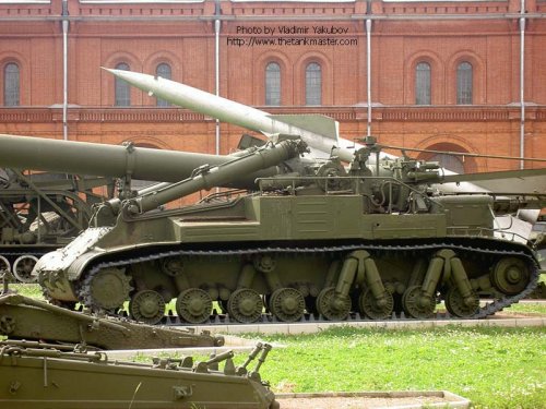

The St Petersburg museum where the first photo was taken does have some very interesting exhibits, some looking remarkably like WW1 9.2 inch Howitzers.
The Sov 240mm also appeared in at least one May Day parade in Red Sq. Of course it was a nuclear delivery system and not designed to fire HE. It probably never entered service because missiles were much more suitable for nucs.

Those drawings are describing them as "420 mm" ! Battleship calibre ! The chassis
looks a bit too small to me, or would those guns have used a much reduced propelling
charge ? If the shell would have been nuclera or conventional probably doesn't matter
with regards to blowback, I think.

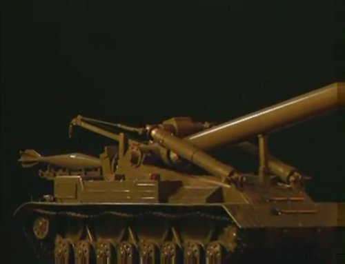

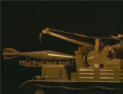

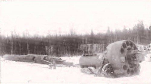

Your absolutely right, Jemiba. The S-103 was some kind of a "monster howitzer". The chassis had problems and at firing it could happen that the barrel bursted (see picture). In the model fotos can the loading mechanism be seen and the atomic shell. And yes, "Kondensator" and "Transformator" were atomic guns. They were the counterpart of the american atomic M65 cannon (thats why the atomic mushroomcloud in the background of the first picture). In hte Kruchshev era this unsuccesful vehicles were soon replaced by tactical missles. See for example wiki:
http://en.wikipedia.org/wiki/2B1_Oka
http://en.wikipedia.org/wiki/2A3_Kondensator_2P

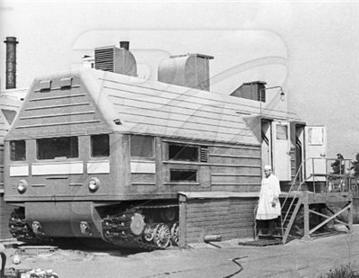

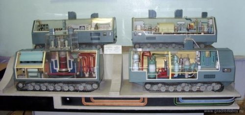

Another cool feature based on the same chassis and made for nuclear warfare was the "atomicpower fighting station" (my rough translation). It should generate (nuclear)power on the battlefield and be a falloutsafe basis (see the last 3 pics).
Regards, Athpilot
