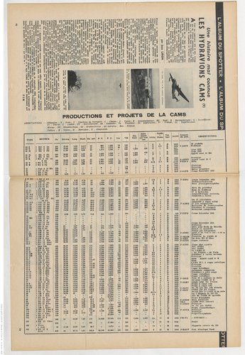

Name Type Year Built
CAMS 30 Prototype 1922 1
CAMS 30 E Trainer 1923 24
CAMS 30 T Transport 1924 1
CAMS 31 M Fighter 1922 2
CAMS 31 P Transport 1923 1
CAMS 32 R Reconn 1923 1
CAMS 33 B Bomber 1924 32
CAMS 33 T Transport 1924 1
CAMS 34 Transport 1925 Project
CAMS 35 Reconn 1925 Project
CAMS 36 Racer 1923 2
CAMS 36bis Racer 1923 1
CAMS 37 Reconn 1926 2
CAMS 37 A Reconn 1926 185
CAMS 37 A-2 & A-3 Reconn 1927 2
CAMS 37 GR Record 1926 1
CAMS 37 LIA Reconn 1926 36
CAMS 37/10 Postal Transport 1926 2
CAMS 37/11 or E Trainer 1932 110
CAMS 37/2 Recon 1926 45
CAMS 38 Racer 1923 1
CAMS 39 ??? 1925 Project
CAMS 40 ??? 1925 Project
CAMS 41 Bomber 1926 Project
CAMS 41bis Bomber 1926 Project
CAMS 42 Bomber 1926 Project
CAMS 43 ??? 1926 Project
CAMS 44 Heavy Destroyer 1926 Project
CAMS 45 ??? 1925 Project
CAMS 46 Trainer 1927 15
CAMS 47 ??? 1925 Project
CAMS 48 ??? 1925 Project
CAMS 49 ??? 1925 Project
CAMS 50 Bomber 1927 1
CAMS 51 C Transport 1927 1
CAMS 51 R Recon 1927 1
CAMS 52 Heavy Destroyer 1930 1
CAMS 53 Transport 1928 15
CAMS 53-1 Transport 1929 11
CAMS 53-2 Transport 1930 5
CAMS 53-3 Transport 1928 4
CAMS 53-4 Transport 1928 5
CAMS 53-5 Transport 1928 ?
CAMS 53R Transport 1929 1
CAMS 54 GR Long Range 1928 2
CAMS 55-1 Recon 1930 43
CAMS 55-10 Recon 1934 28
CAMS 55-10 Col Recon 1935 4
CAMS 55-11 Recon 1934 1
CAMS 55-14 Recon 1934 1
CAMS 55-2 Recon 1931 29
CAMS 55-3 Recon 1932 1
CAMS 55-6 Recon 1933 1
CAMS 56 Transport 1929 4
CAMS 57 Transport 1929 1
CAMS 58-0 Transport 1930 1
CAMS 58-2 Transport 1931 1
CAMS 58-3 Transport 1933 2
CAMS 80-1 Recon 1932 1
CAMS 80-2 Recon 1934 1
CAMS 90 Recon 1931 1
CAMS 110 Recon 1934 1
CAMS 120 Recon 1935 1

My attempt at a CAMS designation list ...
___________________________________
Chantiers aéro-maritimes de la Seine (CAMS) Designations
CAMS 30 - 1923 single-engined pusher biplane flying boat, span 12.40 m
- CAMS 30E: 1923* 2-seat military training flying boat, x 30
-- CAMS 30E: 1 x 150 hp Hispano-Suiza 8A V-8, 4-blade wooden prop
-- * Prototype CAMS 30E completed Dec 1922, first flown in Jan 1923
-- CAMS 30E: http://www.airwar.ru/image/idop/flyboat/cams30/cams30-2.jpg
-- 3-view: http://www.samolotypolskie.pl/uploads/Products/product_617/CAMS-30E_rys.jpg
- CAMS 30T: 1924 4-seat Hydravion de tourisme derived from CAMS 30E
-- CAMS 30T: 1924, 1 x 180 hp HS 8AC V-8, 4-blade wooden prop, x 1
-- aka CAMS 30E Air Salon, Chantiers Aeromaritimes de la Seine (F-AGCI)
CAMS 31M - 1922 single-engined pusher biplane flying boat, 300 hp HS 8Fb
- CAMS 31 Type 22: 1922 1st prototype, span 11.20 m, 2 x 7.7 mm Vickers
- CAMS 31 Type 23: 1923 2nd prototype, reduced span wing w/ wider chord
- CAMS 31M: Militaire, proposed flying boat fighter prod'n version
- CAMS 31P : 1923 Hydravion de transport postal, 1 x built
-- http://c8.alamy.com/comp/E3YMP8/cams-31b-E3YMP8.jpg
CAMS 32 - 1922 single-engined pusher biplane flying boat, span 12.40 m
- CAMS 32R: 1923 2-seat recce flying boat, 1 x 180 hp HS 8AC, 1 x built
-- Folding wing devel. of CAMS 30, first CAMS design by Maurice Hurel
CAMS E32 - [Project] 1932 metal-hulled maritime patrol flying boat
- CAMS E32: 4 x G&R 9Kbr radials arranged in two tandem pairs
--The anomalous 'E' in the E32 designation is probably for Étude
CAMS 33 - 1924 push-pull biplane coastal recce-bomber, span 17.12 m
- CAMS 33B: 1924 3-seater, 2 x tandem 275 hp HS 8FG, x 32 built
- CAMS 33C: [?? same as CAMS 33T ??]
- CAMS 33T: 1925 6-passenger transport deriv., 1 x prototype
-- 3-view: http://aviadejavu.ru/Images6/FT/FT1923/07/439-1.jpg
-- Flight, 27 Sept 1923 mentions a "C.A.M.S. type 33 Bis flying boat"
CAMS 34 - (Project) 192? civilian transport flying boat
- CAMS 34: 1 x 300 hp Fiat A12 inline 6-cyl., span (??) m
- CAMS 34: Derived from CAMS 30 flying boat design
CAMS 35 - (Project) 192? hydravion militaire (role?)
- CAMS 34: 1 x 320 hp Lorraine (Da ??) V-12, span (??) m
CAMS 36 - 1922 single-seat tractor biplane racer, span 8.60 m
- CAMS 36 : [Project] single-seat pusher fighter, not completed
- CAMS 36 : 1922 racer adapt* of fighter airframe, 1 x 300 hp HS 8Fd
-- * Schneider Trophy, built as pusher, conv. to tractor arrangement
- CAMS 36bis : 1923 Schneider Trophy racer, 1 x 360 hp HS 8Fd
CAMS 37 - 1926 multipurpose pusher biplane flying boat, span 14.50 m
- CAMS 37 : 1926 prototype observation flying boat, 1 x built
- CAMS 37A : 1926 amphibious observation flying boat, 185 built
-- CAMS 37A : 1 x 450 hp Lorraine-Dietrich 12Ed W-12 pusher
- CAMS 37/2 : Flying boat vers. of CAMS 37A amphibian, 50 built
- CAMS 37A/3: Reinforced hull vers. of CAMS 37A, 2 x built
- CAMS 37A/4: [??]
- CAMS 37A/5: [??]
- CAMS 37A/6: Enclosed-cabin Aéronavale 'admiral's barge',* x 3
-- * Avia France lists CAMS 37A/6 as 4-seat liaison version
- CAMS 37A/7: 4-seat liaison vers., 36 x built, aka CAMS 37 Lia
- CAMS 37A/8: [??]
- CAMS 37A/9: 4-seat liaison vers., alum. metal hull, 4 x built
- CAMS 37/10: Catapultable postal carrier (for CGT), 2 x built
- CAMS 37/11: 4-seat liaison/trainer vers., wood hull, 110 x built
- CAMS 37/12: 4-seat civilian transport vers., wood hull, 1 x built
- CAMS 37/13: Medevac transport, wooden hull, 1 x built, aka 37bis
-- ** Wikipedia lists as a metal-hulled catapult launch version
- CAMS 37bis: Same as the CAMS 37/13 (above)
- CAMS 37C - Commerical transport prototype, mod. to CAMS 37GR
- CAMS 37E - École, Aéronavale designation for CAMS 37/11
- CAMS 37GR: Grands Raids distance vers., 1 x conv. of CAMS 37C
-- *** Avia France says "Amphibie de raid" but no u/c in evidence
CAMS 38 - 1921 single-seat tractor biplane flying boat racer, span 8.60 m
- CAMS 38: [marché 869/2] 320 hp HS 8 Spécial V-8, 4-bladed prop
- CAMS 38: [marché 899/2] 380 hp HS 12Fd Spécial V-12, 4-bladed prop
- CAMS 38: Built to marché 899/2, x 1 (F-ESFB) for 1923 Schneider Cup
CAMS 39 - (Project) 1925, no details
CAMS 40 - (Project) 1925, no details
CAMS 41 - (Project) 1924 study for a flying boat bomber
- CAMS 41 : 2 x 800 hp engines (or 2 x 400 hp Lorraine 12Db?)
- CAMS 41bis: 2 x 900 hp engines, aka CAMS 42
CAMS 42 - (Project) 1924 study for a flying boat bomber
- CAMS 42: 2 x 900 hp engines (or 2 x 450 hp?), aka CAMS 41bis
CAMS 43 - Military flying boat, 2 x 420 hp G&R Jupiter 9A
- CAMS 43: Derived from civilian CAMS 41 project
CAMS 44 - (Project) 1925 heavy flying boat torpedo bomber
- CAMS 44: Powerplants range from 900 to 1000 hp
CAMS 45 - (Project) 1925 flying boat racer
CAMS 46 - 1926 2-seat trainer CAMS 30 deriv., span 12,00 m, x 15
- CAMS 46E: École, basic trainer, 1 x 150 hp HS 8Aa V-8, x 1
- CAMS 46ET: Intermediate trainer flying boat, 1 x 180 hp HS 8Ab
CAMS 47 - (Project) 1925, no details
CAMS 48 - (??)
CAMS 49 - (Project) 1925, no details
CAMS 50 - 1927 3-seat flying boat, 2 x 480 hp Jupiters, span 20.20 m
- CAMS 50: Intended CAMS 33 successor, 1 x prototype
CAMS 51 - 1926 push-pull biplane transport flying boat, span 20.40 m
- CAMS 51R3: CAMS 51 001, 3-seat recce seaplane, folding wings, x 1
- CAMS 51C : 1927 CAMS 51 001, 6-seat transport flying boat, x 1
- CAMS 51C : 1928 re-engined with 2 x 480 hp G&R 9Akx, F-AIMS
CAMS 52 - 1929 2-engine, high-wing monoplane floatplane, span 30.36 m
- CAMS 52: 2 x 480 hp G&R 9Akx, built 1929, flown 1930, x 1 (F-AKAH)
CAMS 53 - 1928 6-seat transport vers. of CAMS 50, span 20.40 m, x ~30
- CAMS 53 : Init'l prod'n vers., 2 x 580 ho HS 12Lbrx, 7 x built
- CAMS 53-1: Strengthened hull, x 12 (+ 7 CAMS 37 conversions)
- CAMS 53-2: Modified hull shapr, x 6 (+ 1 CAMS 37/1 conversion)
- CAMS 53-3: 2 x 480 hp Jupiter radials, x 4 (redesig. CAMS 56)
- CAMS 53R : 1929, 2 x 500 hp Renault 12Ja, x 1 (redesig. CAMS 57)
CAMS 54 - 1928 long-distance push-pull biplane flying boat, span (??)
- CAMS 54GR: Grands Raids, 500 hp HS 12Mbr, x 1 ('La Frégate')
CAMS 55 - 1929 5-seat CAMS 53 transport flying boat deriv.
- CAMS 55H : Hydravion, CAMS 55 prototype, aka CAMS 55-001
- CAMS 55-1 : 1929, 2 x 600 hp Hispano Suiza 12Lbr 600, x 43
- CAMS 55-2 : 1929, 2 x 480 hp Gnome Rhone 9Akx, 29 x built
- CAMS 55-3 : 1932, 2 x 600 hp Hispano Suiza 12Lbr 600, x 1
-- CAMS 55-3: Metal hull, built by Dyle et Bacalan, Bordeaux
- CAMS 55-4 : 1931, 2 x 600 hp Lorraine 12Fa, (?? built ??)

From Aviation magazine 1961,
here is a list for it,the strangest thing is CAMS-53/4 and Type-832 ?.
Thanks hesham. I've made a few detail additions to the designation lists ...
Thanks hesham. The CAMS 33T is usually associated with that Saint-raphaël to Ajaccio race. That suggests that the CAMS 33C (F-AHDB) was perhaps a (temporary?) redesignation from Transport to Course.
