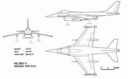

Maybe the HS.1205-5 ? The attached drawing comes from Michael Pryces and Michael Hirschbergs
paper "Beyond The Harrier"mentions, that AST 403 was strongly influenced by the appearance of the
F-16 and that several proposals resembled it and the F-18.

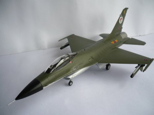

Just as a bit of fun I had a friend of mine make up an RAF Germany from the late 70s still with Red Tops to save money. I also have a Firestreak version in silver
British Secret Projects has a drawing of HS.1202-9, which looks like a foreshortened F-16 with twin tails. (There is a thread here but the images have been removed.) Quite a remarkable resemblance, even if that isn't what was being referred to in the Economist.

British Secret Projects: Jet Fighters Since 1950 has a picture on Page 145 of the HS.1202-9 captioned 'Britain's very own F-16'
It was larger with a 3m increase in the wingspan and 1m increase in length and had twin tails.
4 Sidewinders, 2 27mm cannon and a variety of ground attack weapons on 4 more underwing hardpoints.
