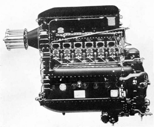

Regarding what became the Matilta II
'Inevitably the question of a suitable power unit arose, and one suggestion involved a Napier-built version of the Junkers Jumo engine, although this was rejected in favour of an AEC unit'.
Any idea what Jumo engine was in mind with this suggestion?

I believe this engine would have been a version of the Napier Culverin, which was itself a licence-built Jumo 204 aero engine.
It would, of course, have to be modified for use as a tank engine, probably quite radically, for, despite appearances, apparantly it was designed to run only in the vertical orientation...
"In theory, the flat layout of the engine could have allowed it to be installed inside thick wings of larger aircraft, such as airliners and bombers. Details of the oil scavenging system suggest this was not possible and the engine had to be run "vertically", as it was on all designs using it."
From http://en.wikipedia.org/wiki/Junkers_Jumo_205
http://en.wikipedia.org/wiki/Napier_Culverin
http://en.wikipedia.org/wiki/Junkers_Jumo_204
