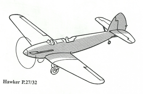

in the Spec. P27/32E for day bomber aircraft,hawker submitted a proposal for low cantilever
wing two seat aircraft project,and maybe a retractable landing gear.

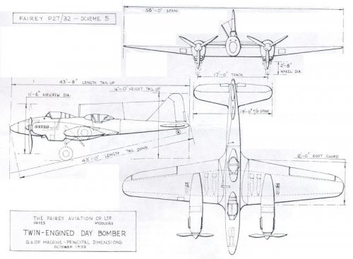

One of the Fairey study?
https://forum.axishistory.com//viewtopic.php?t=180704

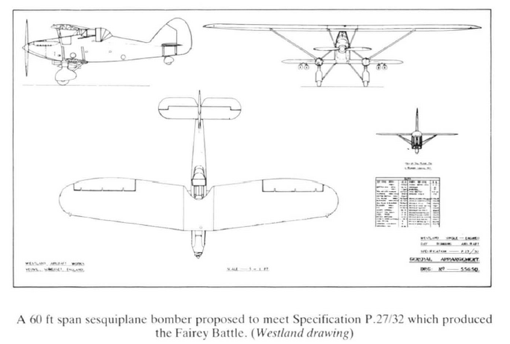

Anther tenders were; Bristol Type-136,Westland Sesquiplane and Vickers Type-246

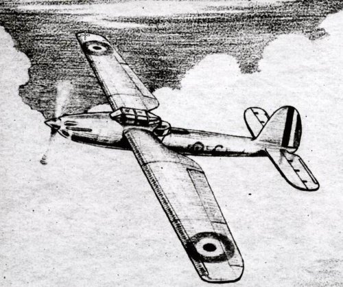

Thankfully via lark from "THE FAIREY BATTLE: A Re-Assessment of its RAF Career" by Greg Baughen,
an artist impression of the tender by Fairey.
Ummm....Wing root moment of inertia of area is small. Structurally hard. ???
https://en.wikipedia.org/wiki/Second_moment_of_area

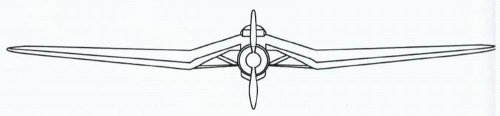

It really isn't recognisable on that drawing (perhaps too much artistic license ?), but for
that reason, there are struts, probably making the whole design not very attractive to
the Air Staff (drawing from the same source mentioned above)

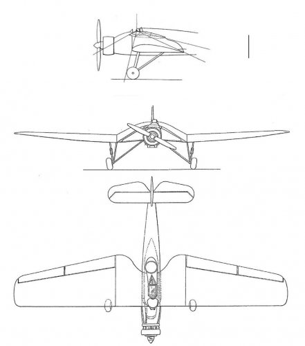

You can see the origins of the design in patent GB430331. Gloster took a similar approach, as seen in the Putnam volume and my article in The Aviation Historian - ripped-off in the Russian link in the above post.
