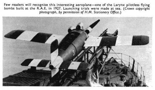

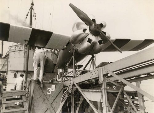

Grey Havoc said:
Hmmm, given that the RAE had been able to build the Long-Range Gun With Lynx Engine (LARYNX) back in 1927, perhaps the BIS might have been able to lay the groundwork for a British V-1 equivalent in the early 1940s?
For lack of a better place to post it, here is a couple of photos of the LARYNX, obviously a pretty advanced concept for 1927.

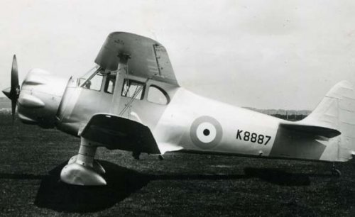

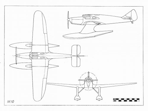

What I meant by advanced had more to do with the fact that it was designed from the start as an unmanned vehicle and in a way resembled some targets that appeared two decades later. But of course in terms of technical progress in radio control the Queen Bee was better. Here are two other unmanned British types from before the war:
  • Airspeed A.S.30 Queen Wasp (specification Q.32/35, 2 built and flown in 1937)
  • Miles M.10 Queen Wasp (specification Q.32/35, also 2 ordered but cancelled before completion)
