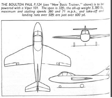

the British Operational Requirement OR.321,for two-seat trainer,which led to
develop Hunting Jet Provost,the tenders were; Avro-714 ?,Boulton Paul P.124,
Hunting P.84 & Miles M.100.

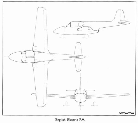

Also I suggest the English Electric P.9 ?,who know more competitors ?.

I am afraid I must correct you Hesham, there were no direct competitors offered under OR.321.
OR.321 was originally raised, along with Spec. T.16/48 Issue 4, to cover the order for the Jet Provost T.1, an evaluation batch of 10 aircraft.
It is true that the Air Staff considered running a tender following the evaluation, the MoS circulated a new draft spec to some companies for their opinions but it was never formally issued.
In the end the Air Staff took the improved Jet Provost T.2 into production as the T.3 under a revised Spec. T.16/48 Issue 5.

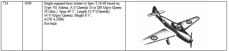

The Avro 714 was related to the original T.16/48 for the piston-powered Provost and nothing to do with jet trainers.
All the other designs you mention were private ventures.
It's worth noting that not every OR and Spec was written to stimulate competition, they were necessary to justify any aircraft order to get the Treasury to release the funds and for the MoS to get contracts issued.

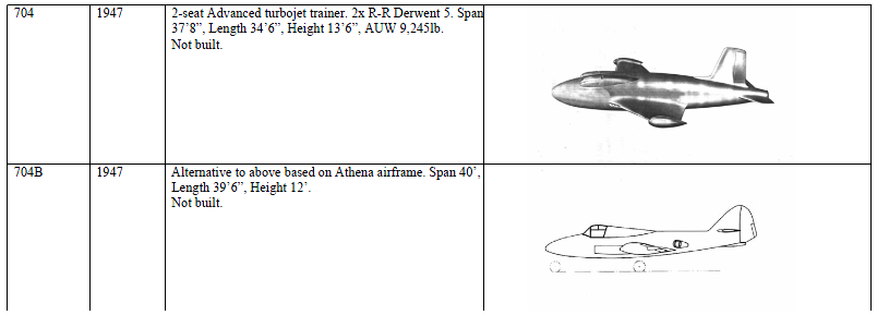

and maybe Avro-704 was also a private venture.

Where is that clipping from?
The Avro 704 is a 1947-48 design, a rather earlier private venture, long dead by the time of the Jet Provost. The 704B crops up, but in surprising places and not connected with Jet Provost either.
PS: I am not Schneiderman, wrong person.
No you're not, but I am :)
The clipping that Hesham showed is from a listing of Avro project numbers put out by the Avro Heritage Centre a few years ago. Do you need a copy?

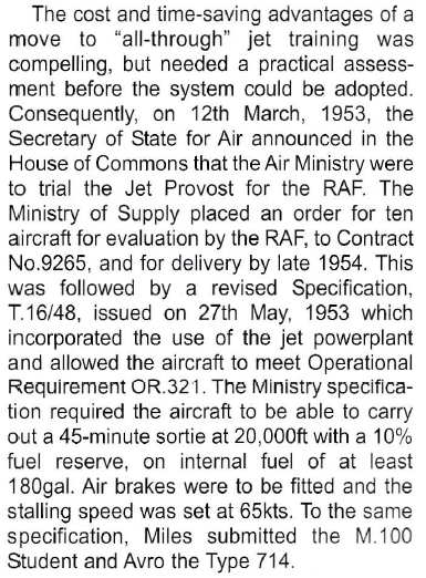

I was referring to the other clipping in post #3 so I could try to understand who lumped all those designs under OR.321.
To be clear, there was a LOT of design activity in this field, practically everyone was at it and waving brochures at the Air Staff.
