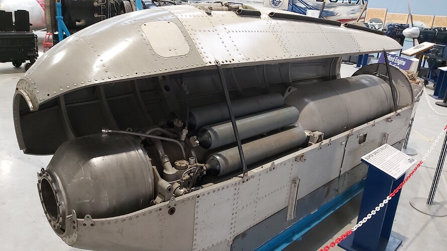

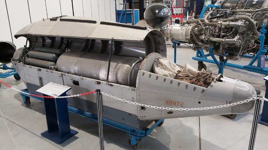

and this, from the De Havilland Aircraft Museum :-
"The de Havilland Super Sprite, the first liquid-propellant rocket engine to have successfully completed a British Government Type-Approval Test, which was in full production for the Royal Air Force. The engine was fitted to the Vickers Valiant four-jet bomber within droppable containers."

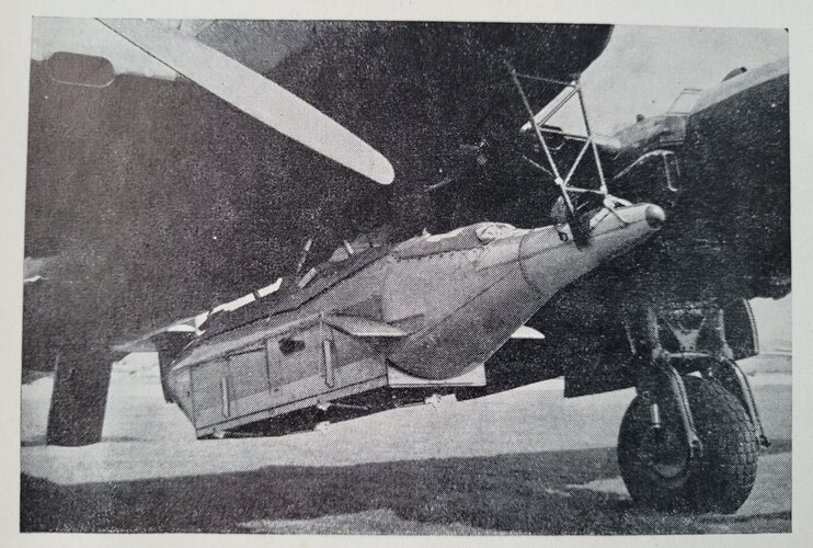

DH. Sprite jettison trials, Bristol Brigand, Hatfield, The Aeroplane, 9 September1955
