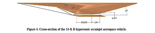

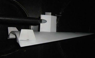

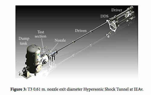

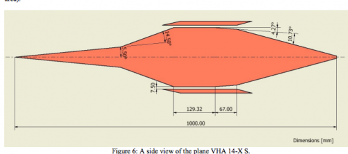

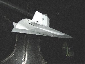

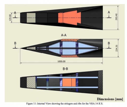

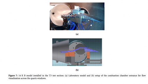

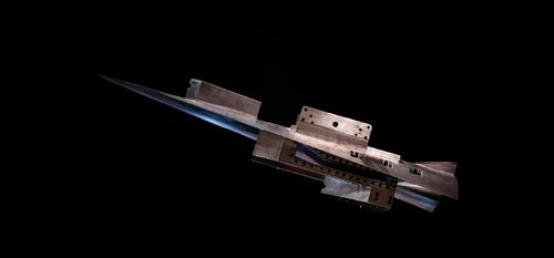

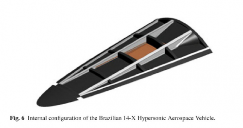

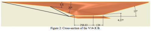

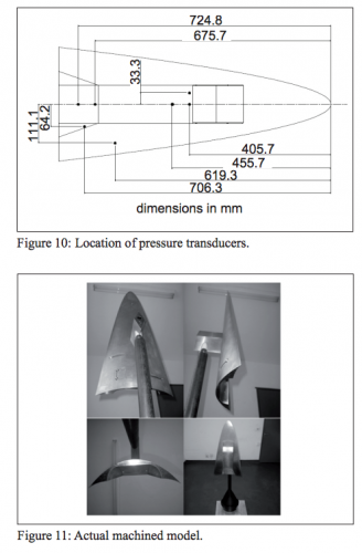

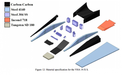

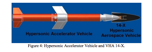

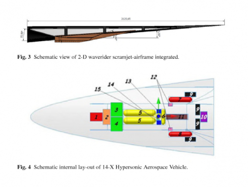

Hi.

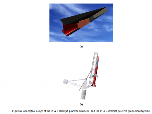

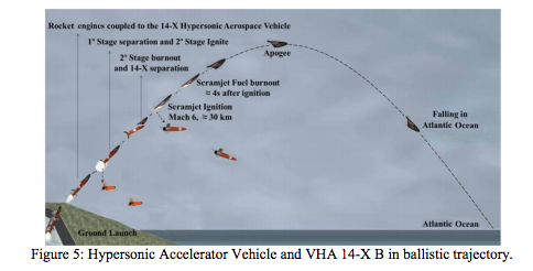

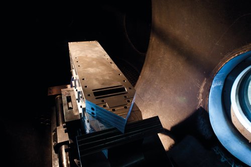

Some pictures extracted from some of the above publications. I was a bit too fast renaming the files. Please correct and change VHA-1B into VHA-14XB. Well… you get it. The name 14B means something: it actually refers to Santos-Dumont "14-Bis" aircraft / kite flown in 1906.

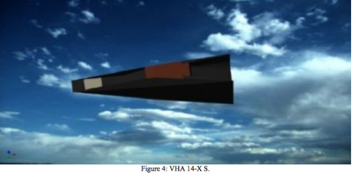

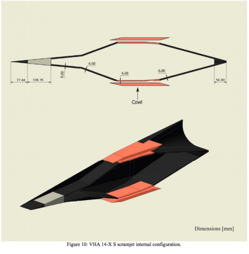

Here is some clarification. As far as I have understood, as of 2018, 3 project variants fall within the scope of FAB's [Força Aérea Brasileira]'s initiative called "Projeto de Propulsão Hipersônica com Ar Aspirado – PropHiper – 14X"
  1. The original "intented" "vision" VHA 14 X aerospace vehicle
  2. An asymmetric, experimental, (single) scramjet powered waverider called the "14X B"
  3. A symmetric (mirror-like), experimental, over/under scramjet configuration called "14X S" discussed at length in a November 2013 paper (maybe earlier)
Other scholar, experimental studies included inward turning scramjet configuration.
That's it.

An interesting related blog post from 2016 where stratasys shows off their 3D printed applications to hypersonic testing…
Carrie Wyman Carrie Wyman, "3D Printed Aircraft Prototypes for Flight Readiness with Stratasys Solutions"
Oct 27, 2016 ;
... matching this scholar publication:
I.S.Rêgoa T.V.C. MarcosbD. Romanelli PintocR.G.S. VileladV.A.B.GalvãodA. PivettadG.P. CamiloaJ.R.T. SilvadB.C. LimadA.K.CarvalhaldR.L.CardosodJ.F.A.MartosdA.M.SantosaA.C.OliveiraaP.G.P.Toroa
"Ground experimentation with 3D printed scramjet inlet models at hypervelocities", Aerospace Science and Technology, Volume 55, August 2016, Pages 307-313
A.

Here is an article of interest published in the January 2019 issue of Pesquisa FAPESP, the science magazine of Fundação de Amparo à Pesquisa do Estado de São Paulo (FAPESP).
This organization, known in english as the "São Paulo Research Foundation" is "a public foundation located in São Paulo, Brazil, with the aim of providing grants, funds and programs to support research, education and innovation of private and public institutions and companies in the state of São Paulo. It was founded in 1962 and is maintained by endowments by the State government which are guaranteed as a fixed percentage of the State's tax, besides the income generated by the financial revenues of its own assets. FAPESP is an important institution for Brazilian science. Its investment on directed and priority projects, such as genomic science and industrial innovation, has resulted in a great international visibility for Brazilian science and technology. It has also supported the use of digital information technologies in São Paulo, such as the Academic Network of São Paulo (the academic Internet provider in the state), SciElo (a digital library), and a pioneering network of virtual research institutes. FAPESP is active in the popularization of science. It publishes a science magazine, which has been awarded the José Reis Award for the Divulgation of Science by the National Council of Scientific and Technological Development (CNPq)." (source: Wikipedia)
The article reference has been added to the timeline above, expanded to 2019.
Two pictures extracted from this reference are attached herein.
A.
Yuri Vasconcelos, "Faster than a bullet — Brazilian researchers develop aerial vehicle capable of hypersonic flight", Pesquisa, Issue # 275, jan. 2019
