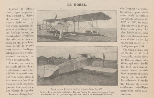

From L'Aeronautique 1921,
here is a racer biplane of 1921.

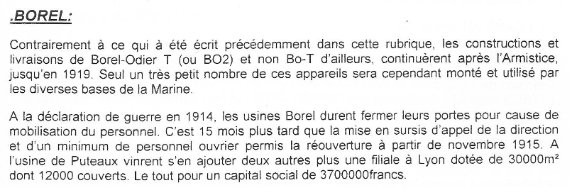

Bo.20 was a 10-seat twin float biplane,as a transport aircraft,developed from Bo-T,and called Bo-C,destroyed before
test in 1919
From TU 193,
as I expected before.

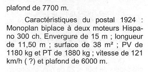

Also TU 279,
- 1924 Postal, a features of postal 1924:
Two-seater monoplane with two Hispano 300 hp engines. Wingspan of 15 m; length
of 11.50 m,; surface of 38 m2 ; PV of 1180 kg and PT of 1880 kg; speed of 121
km / h (?) and ceiling of 6000 m.
