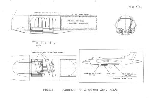

Hello everyone. I'm looking for information about the 30mm Aden gun pack which was intended for the Buccaneer. Does anyone know where I can find some more info?

I've never seen any drawing published. It was not built. It was included in the original specification, so it might be in the NA39 proposal brochure.
According to Roy Boot the proposal removed the bomb bay door and filled the bay with a gun and ammunition pack mounted at the front, with space behind for additional ammo or fuel.
