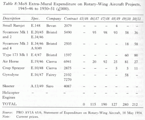

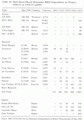

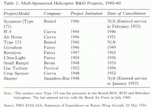

Just reading Matthew Uttley's "Westland and the British Helicopter Industry 1945-1960" I stumbled across the Bevan small ramjet helicopter project for Specification E.1/48, initiated in 1948 and cancelled in 1953. Checking all my sources (incl. the WWW) I even cannot find a company with this name (no entry in Gunston's Encyclopedia of Aircraft Manufacturers).
The Forum is my last hope ...

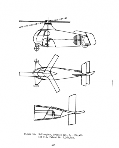

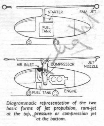

this Patent was probably from late of 1940s,is it related to De Havilland TK.10/TS.10 ?.
http://www.secretprojects.co.uk/forum/index.php/topic,24688.0.html

I've dug out the relevant file at Kew (AVIA 54-768) and while it provides a few answers it does at least give the background to this project.
As Apophenia highlights here (http://www.secretprojects.co.uk/forum/index.php/topic,26602.msg272306.html#msg272306), Bevan Bros. built an Isacco rotating-wing parachute in 1947 and a couple of technicians there began working on small ramjets.
Capt. R.N. Liptrot who crops up in many a British aircraft project history, by 1947 had been appointed as DDRD. Helicopters.
He had harboured a desire to build a small helicopter based on the Rotorchute and he suggested the firm should submit a proposal for a ramjet-powered helicopter.
The company would develop the rotor which would be fitted to an Fa-330 or a Rotachute airframe following ground tests. The RAE felt the project was feasible but had doubts an inexperienced firm would be able to make early success and advised a step-by-step development programme.
Spec E.1/48 was issued in December 1947 to cover this work and contract 6/Acft/2079/CB.9(a) was awarded to Bevan Bros. Aeronautical Engineers Ltd., Rettendon Common, Chelmsford, Essex to develop the rotor. Liptrot felt the development would only cost £8,000. It was planned to issue a second contract for the actual helicopter.
Liptrot felt a two-blade rotor would work but the RAE felt a single blade or triple-blade would be better to reduce vibration. There were some worries over yaw control in the hover but it was thought a separate control system would not be required.
Steve Coates and Jean-Christophe Carbonel's 'Helicopters of the Third Reich' states two Fa-330 airframes were assigned to Bevan Bros. and serialled VX259 and VX266. Work continued during 1949, it seems at least low-speed tests on the ramjets were undertaken and a wind tunnel was built (completed?) but the project was cancelled on 24 Feb 1950. Another Fa-330 was assigned to Bevan Bros. on 18 April 1951 and was serialled VX850 but there the trail goes cold.
I think we can safely discount the De Havilland TK.10/TS.10 from this Spec. TK-designs were apprentice designs rather than proper projects and Bevan was intended as the sole firm to do the ramjet work.
