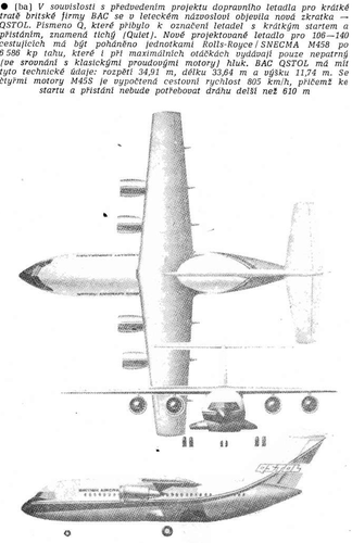

Widebody transport seating 108-140 passengers with an externally blown flap system for STOL.
Powered by 4 6,600kgp RR/SNECMA M45S/RB410 geared-fan turbofans, based on the M45H gas generator with a Dowty Rotol variable pitch fan added. STOL MTOW is 56,170kg, carrying 108 passengers for 965km from 600m field lengths, with ranges up to 1610km with higher weights and longer takeoff run. Span: 34.9m, Length: 33.63m.
Air Enthusiast August 1971

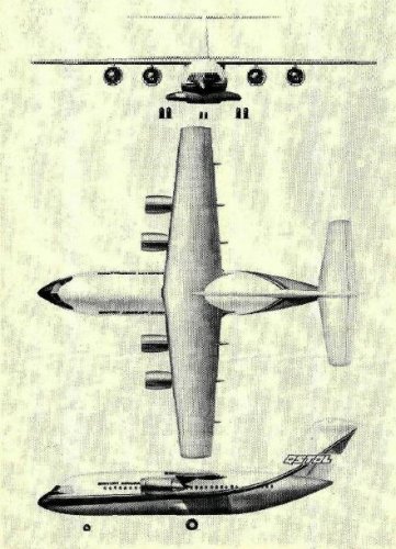

http://www.flightglobal.com/pdfarchive/view/1972/1972%20-%200914.html

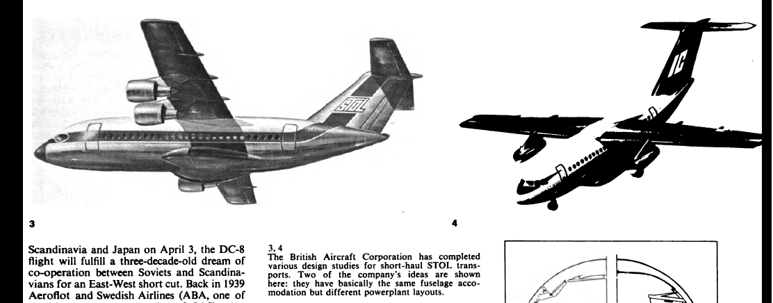

From Flying Review Volume 19 No 4,
sorry,it was for AW.681.
May be you are right Starviking,
I will correct it.

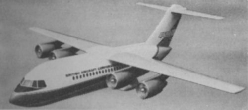

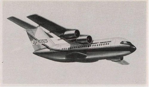

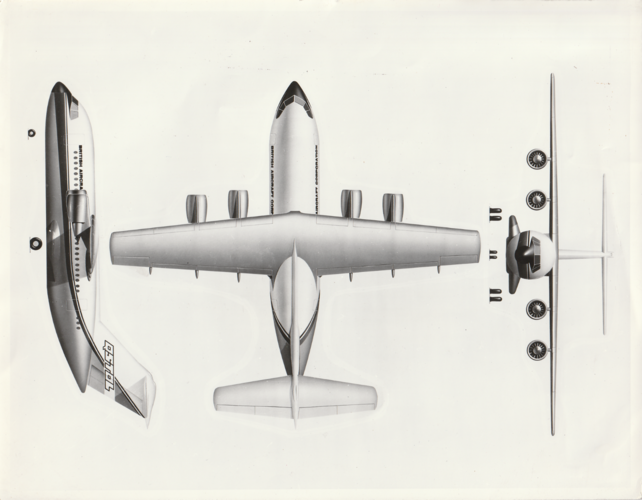

Model of the BAC Q-STOL exhibited at Le Bourget 1971, from Aviation Magazine 565.

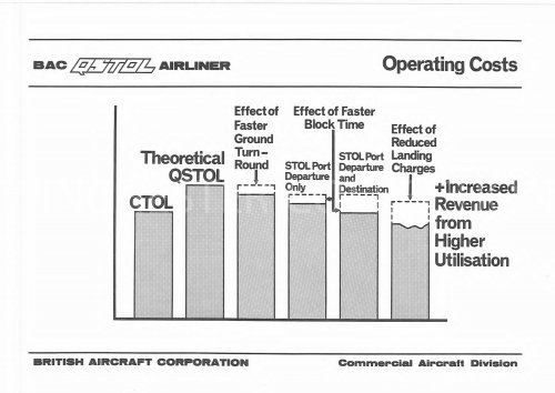

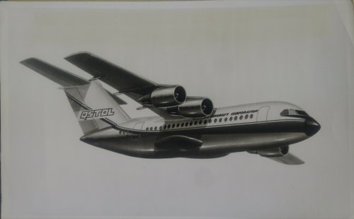

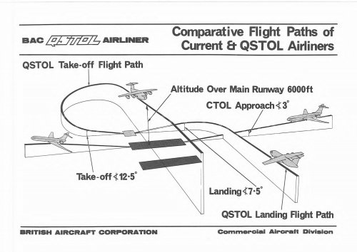

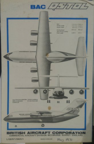

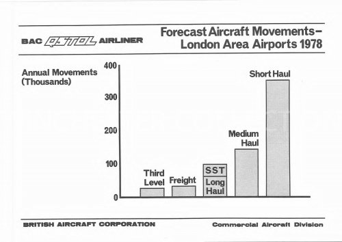

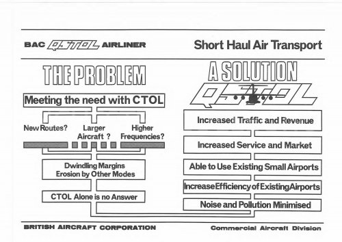

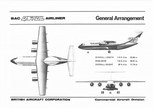

BAC QSTOL manufactures brochure, a recent addition to my collection...
Zeb

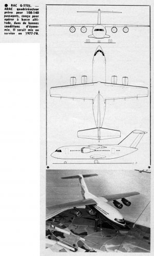

From L+K 1971/18,
with more Info.
