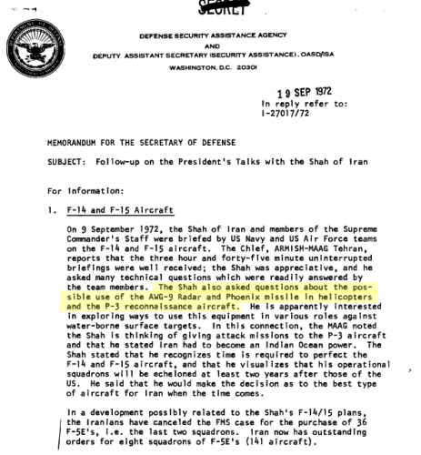

Hello,
Recently i found out a PDF file regarding Military sells of US to Iran before the revolution. The part of the text mentions that Shah was curious to know whether is it possible to equip the P-3Fs and Helicopters to AWG-9 and ultimately AIM-54 Phoenix missile. According to another threat ( http://www.secretprojects.co.uk/forum/index.php/topic,18397.msg192692.html#msg192692 ), even Japan had a same idea for their P-3Cs.
Well the main question for me is that based on Imperial Iranian Naval aviation in that time:
-AB 205A/206
-ASH-3D, which of these could be modified and be equipped with AWG-9 and AIM-54 (most probably SH-3Ds) and also was there any counterpart project as such for the US Fleet ?
Thanks a lot in advance,
Regards,
~Ak

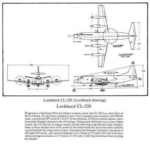

Which means it would potentially look something like this - The Lockheed CL-520 'Land-based Fleet Air Defence weapons system!
Regards
Pioneer
Regards
Pioneer
