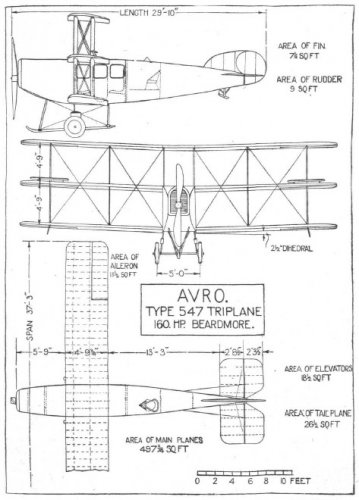

Bailey said:
I wonder how close the "Type 550" was in relation to the Type 547.
Apparently not very much, other than being a triplane..
The Avro Type 550 Amphibian Triplane design was for:
-a single-bay,/vs. double bay
-uniformly-staggered, narrow-chord triplane,/vs no stagger
-with a gap between the centre plane above the two forward cockpits./vs. no gap
-The middle & upper wings supported at their inboard ends by splayed cabane struts,/vs. vertical cabanes
-and the outer ends of the three planes supported by single faired interplane struts./vs. double interplane struts
-The aircraft was powered by a Bristol Jupiter engine./400-500hp vs 160 hp Beardmore

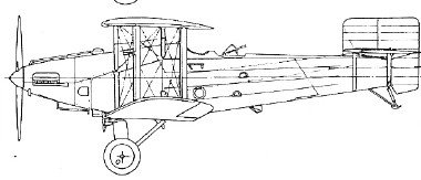

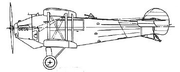

Bailey said:
I agree....but only if we believe the description of the 550 given above is totally correct.
What bothers me, rightly or wrongly is that the description of the "Type 550" as a Carrier reconnaissance plane does not seem to gel with the style of designs that Avro were producing for other Navy planes to similar specs at around the same time.
See the drawings of the Bison from 1921 and the Buffalo from 1923.
Regards Bailey.
