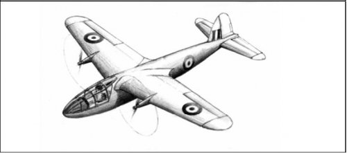

A project of 1936 for a fighter with one Merlin and two propellors one on each wing.
Has anyone any details, please?
There's an illustration on the site of the Avro Heritage group, I think...
I had a look in "Avro Aircraft since 1900" (or a similar title anyway) which lists the types in back. The note for the Type 678 is simply that it had one Merlin engine and two propellors. Nothing else.
I'll have to check but there may be something in Tony Buttler's Secret Projects Vol.3. I known I've seen a drawing of the 678 somewhere in a book.
Yes I was right, in the Project Summary in the back of BSP: Fighters & Bombers 1935-1950 there is some very limited data.

It mentions no offical specification so I'm presuming it was a private venture. A 3-view is also included but it seems the same as the one on the avroheritge site. I'm not sure where the armament was to go, wing-mounted guns seem unlikely given the two propellers and there is not enough room in the nose.

Incidentally, the picture I saw on the Avro Heritage website was a rather nice artist's impression, not the 3-view, so double thanks. But based on that their seems to be room for a gun bay under the pilot's seat - where the cannon go in a Mosquito. Depends exactly where the engine was to be.
from Avro Heritage site;
http://homepage.ntlworld.com/david.fildes3/Type%20602%20to%20862

Single engined. Planned powerplant was a Rolls-Royce Merlin "mounted in fuselage driving
wing-mounted propellers", no further info available at the moment.

For me it hasn't much of a fighter, although armament could be installed in
the lower fuselage, with the gun barrels or troughs under the pilots seat. But the cockpit
layout seem to be prone to problems with the gunsight, see the similar discussion about
a fighter derivative of the Bugatti racer.
Actually, it reminds me very much on the Miles M.30X, the sub-scale demonstrator for
the Miles X. Of course, it's called a fighter in two sources, but nevertheless I have doubts
about it.
