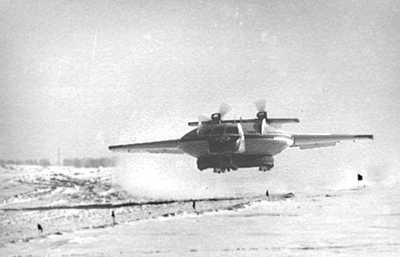

The confusion as to a "winged" version might stem from http://unrealaircraft.com/wings/thermoplane.php. On this webpage is shown two photographs, supposedly both of the (or "a") Thermoplane. The upper one shows the Thermoplane demonstrator, however the lower one is the Bella-1 VTOL demonstrator, courtesy of the "Tumenecotrans" company (http://www.tumenecotrans.ru/bella2.html).

That Tumenecotrans site is definitely worth a visit, though I didn't see anything more than a short hop in the video clips. Note that the Bella is not a VTOL aircraft, it is a STOL aircraft with an air-cushion landing gear for all-terrain, off-airport operations.
Mole said:
Note that the Bella is not a VTOL aircraft, it is a STOL aircraft......
Oh, well....I saw that big fan in the middle and jumped to a (vertical) conclusion ;)
I stand corrected.
Regards,
Thomas L. Nielsen
Denmark

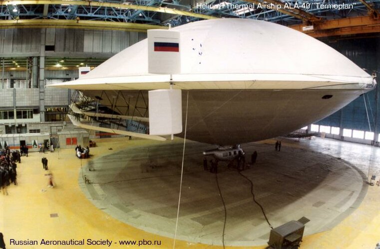

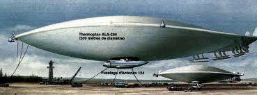

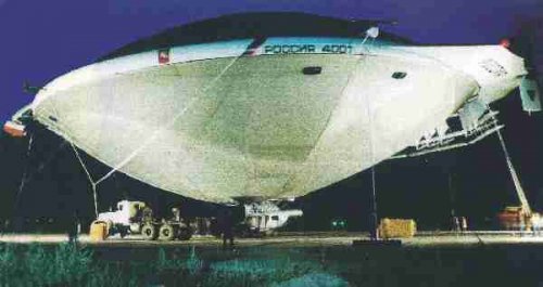

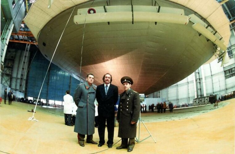

Some photos of the Thermoplan:
