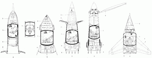

The kit is quite unlikely, Korolev has some sketch-plan to launch a man into space atop an R missile exploting one of the "capsule" (more than an aerodynamic fairing) also utilized by dogs.
The kit is also wrong depicting the pilot seat not in the direction of motion but "head up".
Korolev knew well, even at that times, that blood would rapidly goes to legs starting in that absurd position causing a loss of couscioness (or worst) to the pilot.

Sincerely I think that the kit is obviously mistaken, the proof is in the original Korolev' sketches of suborbital capsules.
None of them resemble that one represented in the kit, and all of them has the cosmonaut placed in the right manner.
Korolev proposed these capsules in 1956-58, he decided to abandon the project when Politbjuro authorized him to proceed with full orbital space vehicle that later become Vostok.
