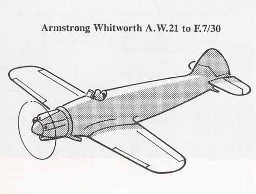

Hi!
In the book "The british aircraft specification file" at pg 46, there is an artist impression of the Armstrong Whitworth A.W. 21, a monoplane fighter designed for the specification F.7/30. Unfortunatly I don't have a scanner, so I can't post the picture, sorry. I'd like to know more about this aricraft and I ask if there are anyone who have more information or drawings about the A.W. 21.
Thank you for your help and, as always, sorry for my english ;)

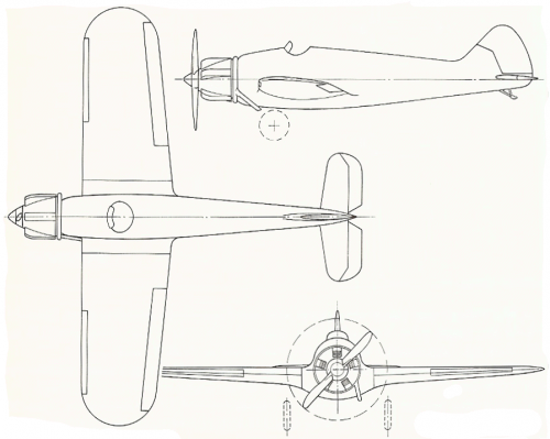

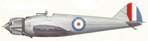

Armstrong Whitworth AW.21 :-
This aircraft, along with the AW.35 Scimitar, was submitted to specification F.7/30,
for a 'Day/Night Interceptor'.
Span (hyena version) 37' 6" (11.43m)
Length ( " " ) 31' 5" (9.58m)
Engine- Armstrong-Siddeley Hyena 15 cylinder radial rated at 505hp
OR Armstrong-Siddeley Panther III rated at 500hp.
Armament- 4 Vickers guns, two each in the forward fuselage and wings.
3-view from Putnam's 'Armstrong Whitworth', page 338.
Colour profile from 'Twentyfirst Profile', volume 1, number 10, page 304.

I finally bought a scanner and I can post the picture of the book (The british aircraft specification file)
