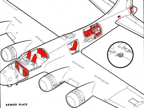

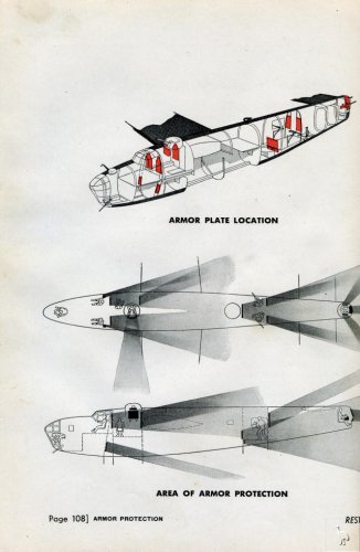

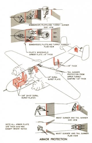

https://ww2aircraft.net/forum/threads/armor-for-pilots-of-american-heavy-bombers.37151/
Thanks Joe, seen all them, thanks. What I'm after is a weight (which I suspect will never be accurate and vary for most types as crew add/staff remove it) for a WW2 bomber. For example the A-10 is quoted as having 1,200lb armour, but that's just the bathtub, no mention of the rest. On the Sturmovik, the armour is stated as being 15% of the gross weight - that's the type of figure I'm after.
