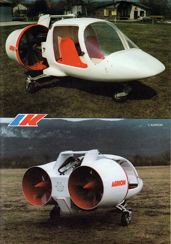

From L+K 12/1993,
here is a strange hang glider ducted fan concept,I can't translate well,and I don't know if it was
its name or not,want help ?.

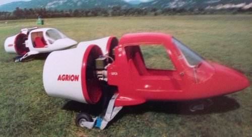

Hi, I did not know this aircraft.
it was French, named L'Agrion (An insect that looks like a dragonfly)
From around 1993
Are involved in its construction : Société française de construction aéronautique SOFCA (French aeronautical building company, specialist in microlight flying devices) and Ackerman Industrie (which builds hydroplanes, hovercrafts, aircrafts).
-2 Italian engines Arrow GT-500 R (500 cc), 65 hp each
-Fuel tanks 40 L or 2x 20 L
-Wingspan : 16 m
-Wing area : 47 m²
-Hull length : 3,20 m
-Hull width : 2,20 m
-Hull height : 1,40 m
-Propeller (not sure) diameter : 0,98 m
-Empty weight :
civilian version : 175 kgs
Military version : 220 kgs
-Max weight :
civilian version : 450 kgs
military version : 500 kgs
At least two were built : https://www.paravol.info/t1910-Vous-cherchiez-un-plan.htm
