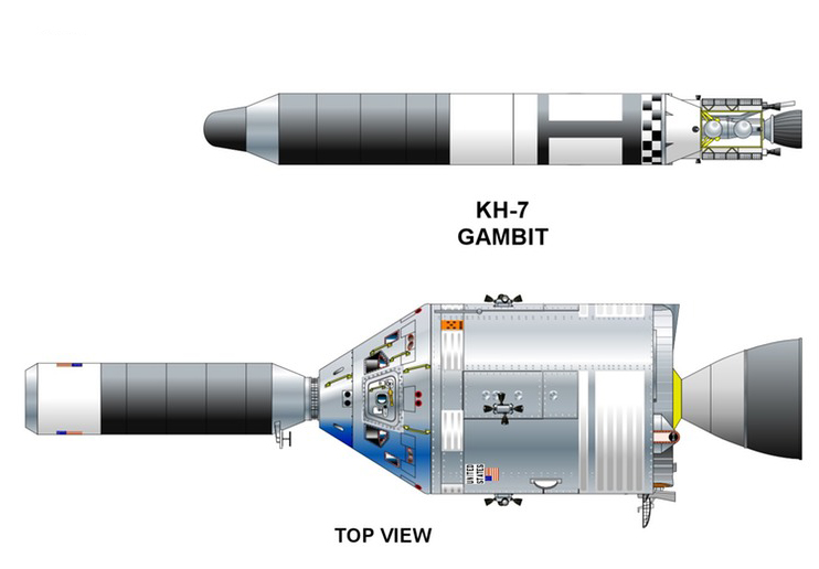

There were talks about Skylab / MOL merging, and an Apollo carrying a KH-7 on its nose, and of Skylab carrying the module in its place. NASA also briefly examined civilian MOL modules for Apollo - MOL pressure vessels stripped of every single NRO hardware.

- LM&SS: Apollo to carry a KH-7 in lunar orbit. Further proposals to attach the thing to Skylab.

Well there were proposals for G.E KH-7 (PERCHERON) and Lockheed KH-8 (UPWARD) . Spysat technology for NASA maybe but NOT for military purposes, since this is not the job of the space agency - not its charter, plus its transparency would be a disaster as far as spying goes. UPWARD and PERCHERON were G.E and Lockheed proposals to NASA to use spysat technology BUT for remote sensing, somewhat a "super LANDSAT". Of course the NRO blew a fuse and shot down these proposals.

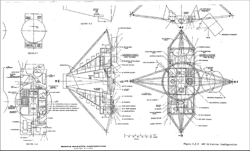

Here's a picture of the AAP-1a mission sensor 'bus', somewhere I have the documentation for this one.
Yeah, that's it. I've seen a report description of this, possibly with some line drawings. I cannot remember if there was a very extensive (hundreds of pages) report done, but the fact that they built a physical model of it implies that they did a more extensive study.
The problem with this concept is the standard one for all these low Earth orbit platforms that include humans: what do you need the humans for? You could take that sensor platform and add a bus and solar panels and not only would it have a much longer lifetime in orbit, but it would undoubtedly be a lot cheaper. A similar argument was made for flying the DAMON payload in the space shuttle when proponents claimed that they could avoid the expense of a satellite bus because the shuttle would provide the power and pointing. Except that while you may have saved money in the short term, you have also dramatically limited the lifetime of the mission, although at least in the shuttle case--unlike this Apollo proposal--you were not throwing the entire human spacecraft away at the end of the mission.
There was a lot of unreality around the AAP proposals of the 1960s. It was like many of the people working on them had no idea how projects got approved and funded. So there were people proposing monthly launching Skylab-type missions and using them for "weather observation" (oblivious to the existence of Tiros). I think that in the mid-60s so much money was going to NASA that a lot of people forgot that it was really only because of the lunar goal, so they started imagining all kinds of other things to do. They started to face harsh reality by around 1966-67 when the budgets began heading south and the layoffs began.

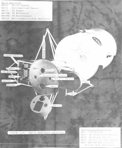

I've found the documentation I have, which all dates from 1967. From a quick re-read it looks to have been a quickest into orbit option to test instrumentation with a flight duration of around 14 days. Amusingly the study had a 'target' launch date of 1 April, 1969. I'm attaching a screenshot of the scaled diagram from the document 'AAP 1A Mission Study, Final Report (September 1967).
