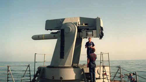

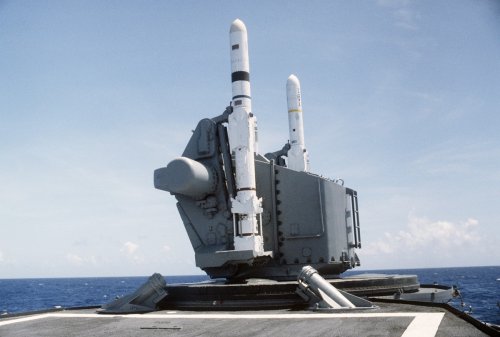

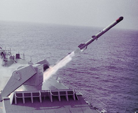

starviking said:
I'll copy my reply, with edits, from the Canadian Patrol Frigate thread.
"I wonder if it's a mistake? Could the Canadians have been wanting ASROC integrated with their Tartar launcher? It was integrated with some Tartar launchers.
Which ones? I'd heard of Tarter/SM-1 being integrated into the ASROC "pepperbox" (on the Knoxs as I recall) but not the other way round. ???
edit: Heh, never mind.
There's also Harpoon.
