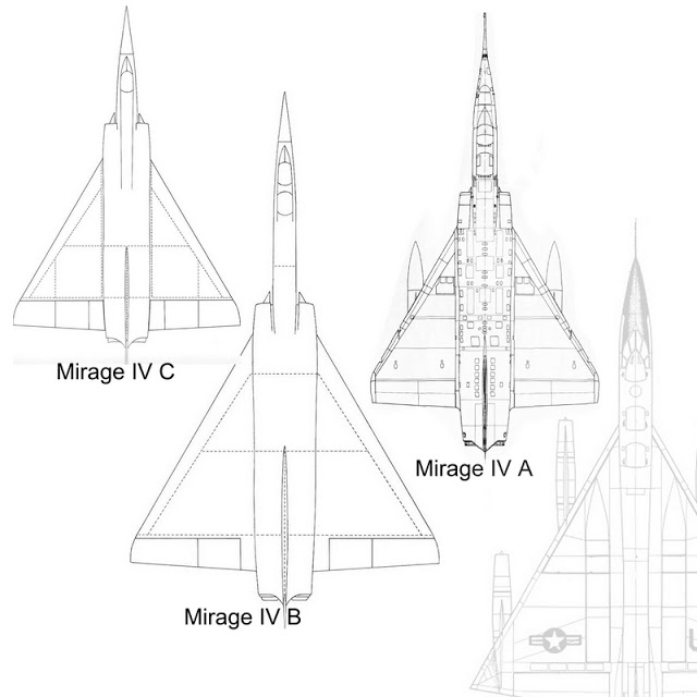

I would love to see some drawings of the
twice bigger Mirage IV-B
Anyone got drawings please??
For this is what the design should have been! Far more effective and versatile!!

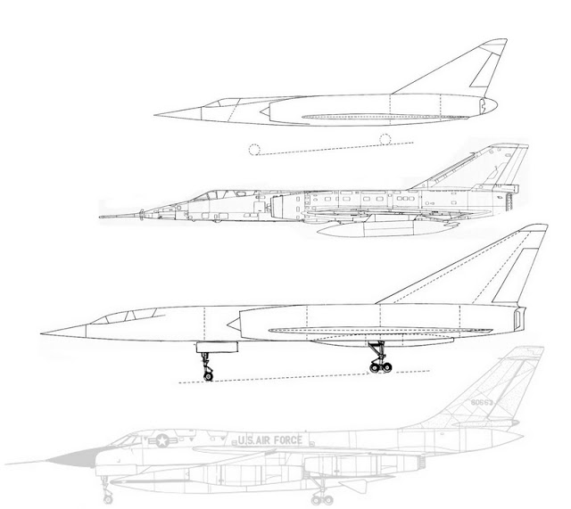

Your wish is my command...
[Source]

the Mirage IVB would have much saner flight characteristics than the B-58 which was kind of death trap - 116 build, 30 crashed, 25% loss rate... :eek:
