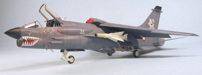

A case could be make that, the J57 stuck into the Crusader... rear end was so large and heavy, the resulting large engine bay & fuselage diameter could have sheltered

I agree that it would have been simpler to opt for a licensed Avon Crusader, with say three 30mm ADEN cannon, AI.23 and Firestreak.
This could then be upgraded with Thames, improved AI.23 and Red Top.
And in turn rather than replace, just upgrade further the AI set and missiles.
I don't know how large were the Red Top and Firestreak but the French Crusaders could carry R530 on the sidewinders fuselage pylons.

Starfighters
Crusaders
Mirage IIIs
Etendards even.
The actual proposals for J79s and Spes do prompt musings on things like Avon and RB.106 alternatives.
Which leads to things like UK Starfighters, Crusaders and Mirage IIIs.
