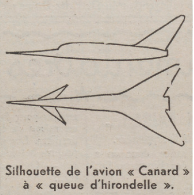

From Ailes 5/9/1953,
Mr Alain Buret (Which Mr. Jean C. Carbonel didn't know his first name in the book; French Secret Projects; Post War Fighters)
designed a canard research aircraft of 1953,the concept was called Tail of Swallow,and maybe the work was done for the
ONERA ?.

The article does not say that he "designed" anything. It says that he made a lecture to an engineers' association.
His point being that while the "swallow tail" (defined as high-sweep trailing edge) has no advantage for a tail-stab plane, this could theoretically be solved by moving the stab to a front (canard) position.
That was a presentation about aerodynamics theory, not about any concrete project.
