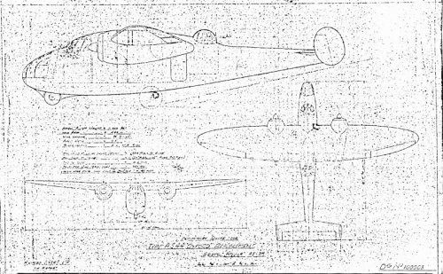

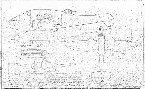

The aircraft was was a very real project, a four-man aircraft with dorsal turret. Top speed around 215mph, according to one blueprint, 234mph on the other two

No, I don't believe it is any issue from 1982, or any other year. I may post 3-view drawings later

Here are the two alternative AS44 layouts

Very interesting. The tricycle undercarriage with a fixed nosewheel on the high-wing design is quite unique/odd! I guess it was fixed so as not to increase the length of the main undercarriage legs so they could still fit into the nacelles.
