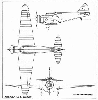

3-view from Airspeed Aicraft since 1931, H.A.Taylor, Putnams.

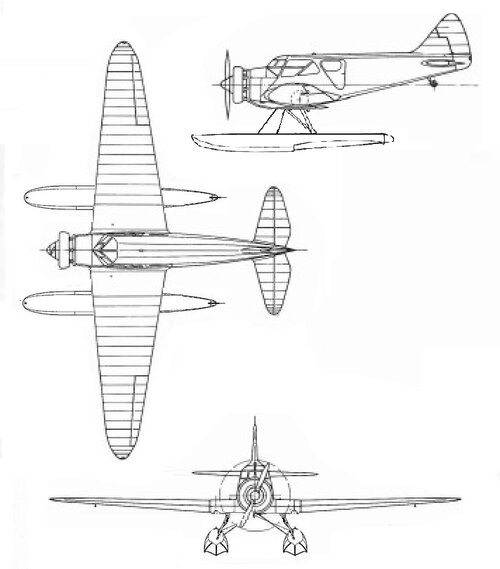

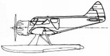

In terms of appearance changes and thinking of the Canadian market, I sort of had a floatplane version in mind, possibly with the Cheetah engine in a long cord cowling. Please see the drawing attached.(Sorry about the quality, not one of my best skills).
Regards Bailey.
