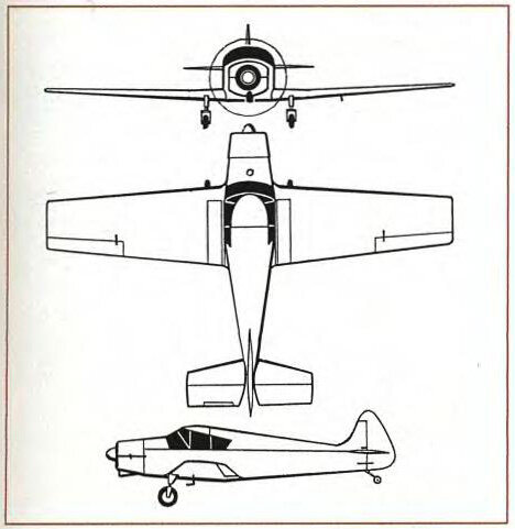

Hello, maybe you can help to complete the list of aircraft designed by the French designer Emile Lucas.
The first construction I know of is the L.4 "Baby Lucas".

Followed by the L.5.

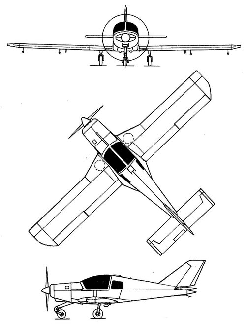

L.6 and L.7

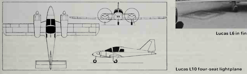

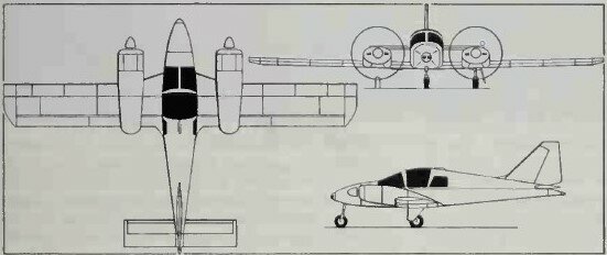

L.8 and L.10 project

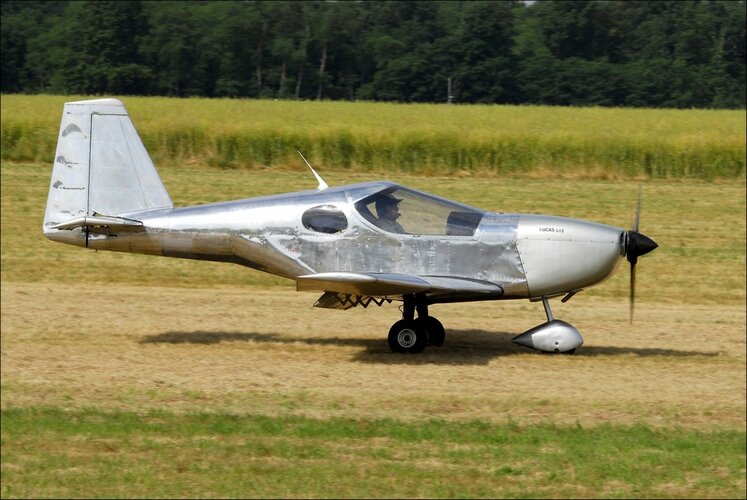

L.11 and L.12

Good stuff Maveric! Here's the same info arranged into an interim designation list ...
Avions Émile Lucas
L1-L3 - (??) See: Reply #10
L4 - 1962* low wing, 2-seat cabin monoplane
- L4 : Home-built, wood/fabric construction
- L4 : 1 x 65 hp Continental A65-8F, span 8.70 m
- L4 : Orig. engine type, 1 x 45 hp Salmson 9-cyl.
- L4 : Side-by-side seating, taildragger u/c
-- * Some sources say L4 1st flight in 1960
-- aka 'Baby Lucas', see reply #1

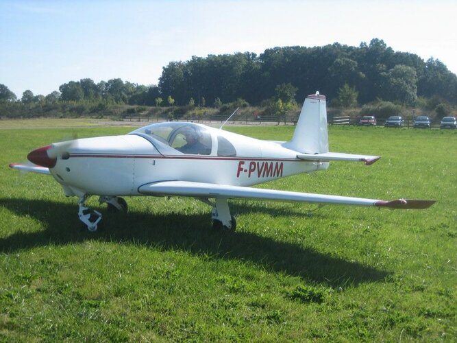

L5 - 1976 2-/3-/4-seat* low-wing sports a/c
- L5 : Metal constr., for home-build market
- L5 : 1 x 115 hp Lycoming O-235,** span 9.20 m
- L5 : Metal constr., trike or taildragger
-- * Variable seating using same airframe
-- ** Stressed for more powerful O-360
-- See reply #2

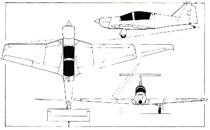

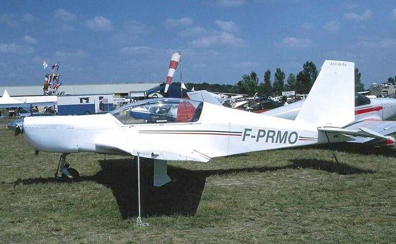

L6 - 1991 tandem 2-seat low-wing sports a/c
- L6 : Metal constr., for home-build market
- L6 : 1 x 80 hp Limbach L2000, span 6.70 m
- L6A: L6 deriv., folding wing motorglider
- L6A: Lycoming 0-235/Limbach, span 14.00 m
- L6A: Retr. taildragger, variable-pitch prop
- L6B: L6 deriv., shorter-span motorglider
- L6B: Lycoming 0-235/O-360 HO4, span 8.80 m
- L6A: Retract. tricycle u/c, c/n 01 F-PRMO

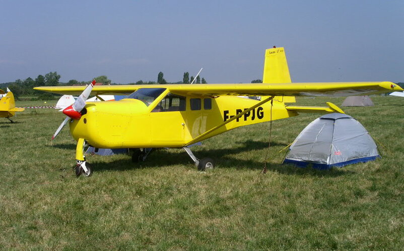

L7 - 1988 2-seat high-winged light home-built
- L7 : Strut braced wings, retract. nose gear
- L7 : 1 x 118 hp Lycoming O-235,* span 10.00 m
- L7 : Boxy utility a/c,** alum. construction
-- * Stressed for engine powers up to 200 hp
-- ** Large doors for baggage or skydivers
L8 - 2-seat low-wing light home-built a/c
- L8 : Side-by-side seating, bubble canopy
- L8 : 1 x 180 hp Lycoming O-360, span 8.00 m
- L8 : Optional fixed or retract. trike u/c

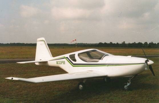

L9 - 2001 4-seat low-wing sports lightplane
- L9 : Metal home-built devel. of Lucas L5
- L9 : 1 x 200 hp Lycoming IO-360,* span (??)
- L9: L5-like sliding canopy w/ larger cabin
- L9 : Retr. u/c, optional tail** or tricycle
-- Possibly same 9.20 m span wings as L5?
-- * NB: L5 was already Stressed for IO-360
-- ** 1st L9 (F-PDVR, c/n 01) was taildragger
-- https://www.rsafrance.com/media/k2/galleries/21/avion_lucas.jpg
-- https://1000aircraftphotos.com/Contributions/KuipersLoet/9963L.jpg
L10 - (Project) Twin-engined light a/c
- L10 : Low-winged, retr. tricycle u/c
-- See reply #4
L11 - (date?) cabin ultralight home-built
- L11 : Side-by-side 2-seat, tapered wings
- L11 : 1 x 85 hp Jabiru 2200, span 8.40 m
- L11 : Metal constr., fixed trike u/c
L12 - (date?) cabin ultralight home-built
- L12 : As L11 except for untapered wings
- L12 : 1 x 85 hp Jabiru 2200, span 8.40 m
- L12 : Metal construction, fixed tricycle u/c
Lucas L.6-7 from Jane´s all the World´s Aircraft.

Hello,
There are no L1 to L3.
Where did you get those draws?
There is also a L9
F-PDVR
Based on a L5
Lycoming IO-360
The Baby Lucas has another engine now: continental A65-8F
